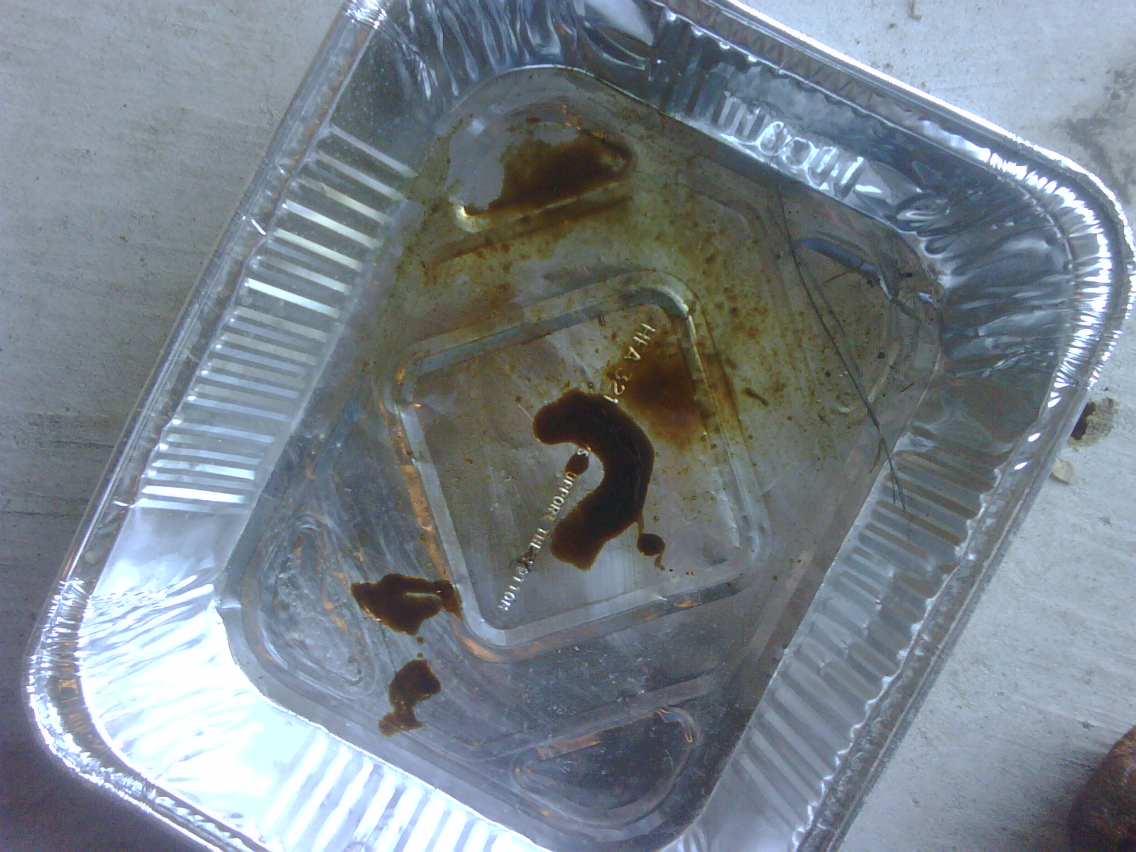

Amazing...................... after 3 days of sitting in the garage, I found drips again on my garage floor and a cloud of smoke came out when I first start the car. My credit card bill is not even here yet from the last damage. Any thoughts ? Is is the RMS, IMS or anything else this time ? The drips that i found came is located in the same area (underneath the engine).
Going back to the dealer is the best you can do in my opinion.

Just took the car out yesterday and guess what, it is leaking again or i shall say, it never stop leaking or it was never fixed properly. I found a small pool of oil on the garage floor again. I called another Porsche dealer (not the same one who fixed my car from last year) and will drop her off sometime this week to replace my rear tires and check out this notorious problem. I hope this is all cover by the 2 years warranty. :(
Confirmed by Pfaff Porsche in Toronto that the leak is casued by RMS which was fixed last year and leaked again 3 days right after being fixed by Downtown Porsche in Toronto and they've checked it again and claimed the leak was from the residual 2 months afte the fix. I think they are full of crap and thats why I didn't go back to them this time. Pfaff Porsche offers far better service compared to Downtown Porsche in terms of professionalism and competence and this repair of course is under the 2 yrs warranty. I will continue to monitor the situation and keep you all posted and hopefully, it is good news from now on.

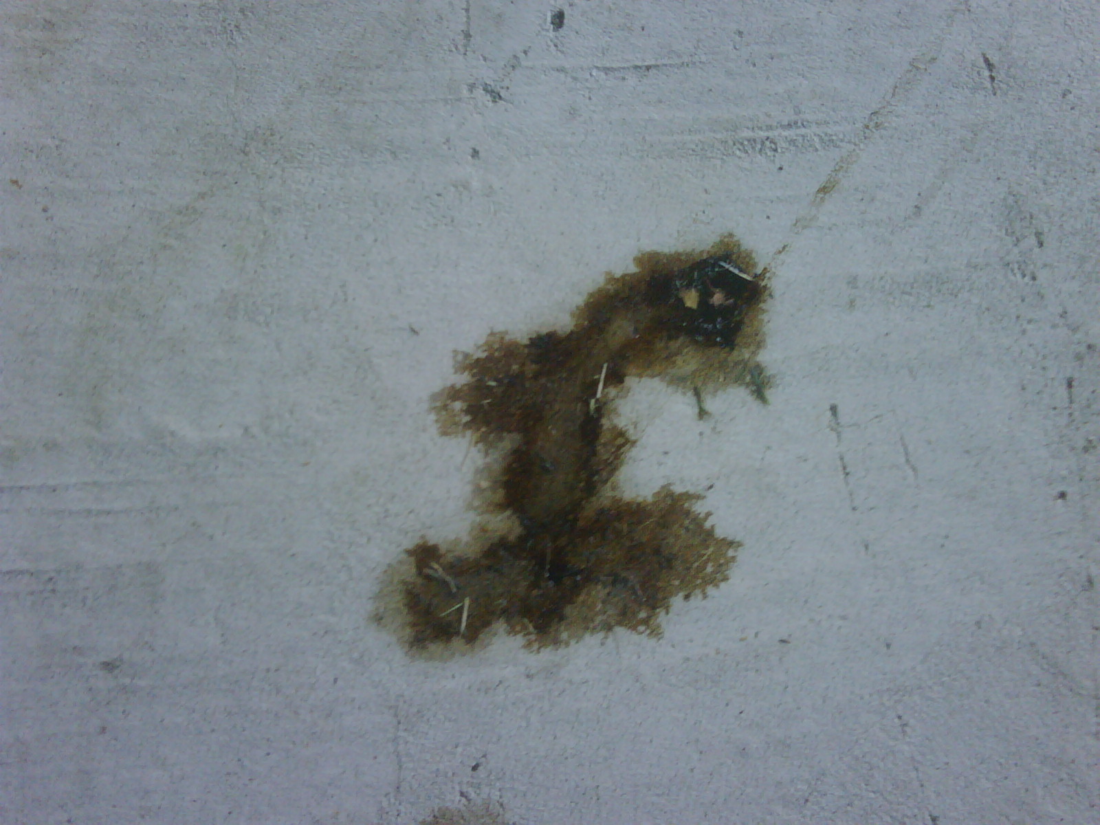

  On 4/6/2009 at 6:37 PM, ssflai said:
These pics were taken before the repair
It is leaking again ..... after four RMS and IMS (including the original ones installed in the car when new, one replaced by the previous owner under warranty and two in the last two years under my ownership), i am going in this Friday for diagnostic for the same problem again. Frankly, i don't think it will go away, my 2 years warranty on this fix will be up soon, this problem didn't go away and I don't think it will. What if it leaks again after this up coming fix and the warranty is out ? I truly think this is a scam now.

@ ssflai, in case of several RMS changes, use the factory instructions: 1) check with the special tool set if the crankshaft flange is placed exact in the middle of the crankcase, if not, replace the engine bloc. 2) if this is OK, place the updated seal using the special tools. Check also if the outer surfaces of the engine bloc (hole ware the seal fits) not have been damaged by removing the previous seals. Place in any case the seal without the tool, they will leak for sure after time.
