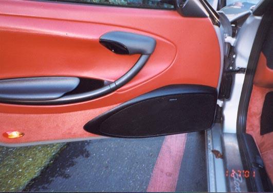

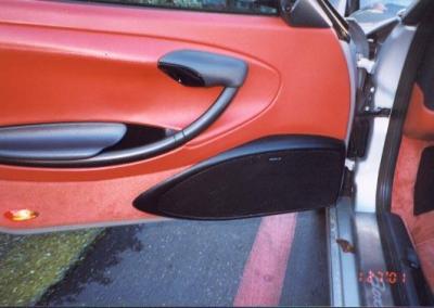

The German company Jehnert makes the HPAS. HPAS was a popular retrofit kit years ago - pre Bose. But if you do not already have the amp in the trunk and the speakers in the door then there is no use for the kit as there is no existing wiring. http://www.jehnert.de/en/
On a Boxster it is simple to put speakers in the doors when it did not come with sound package. Our door cards are flat for the speaker location if the cards do not have speakers. On a 996 you have a storage bin in the door when there is no speaker. That is what Loren has. I do not know if it makes a difference on a 996.
Jehnert, TechArt, and other companies I do not remember sell the housing for a speakers in the door card. Then you should have an external amp in the boot to drive the door speakers. You also have to run wires into the door.
This is the Jehnert housing on a Boxster
