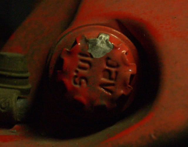

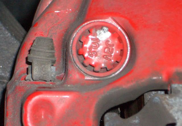

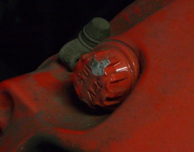

Snapped some pics today, hope this helps. still seems like no-one has ever heard of them. going to order one of these bolts, maybe i can get a tool dealer to match it up to something.

That's a strange bolt head ... not a hexagonal head (12 point) for sure - as Moose described earlier, it is a 10 point or spline head.
nope. can't use a hex, bi-hex or torx socket on it.
like i said before, it's 10-point and the closest i have to that is a 5-point 12.5mm-flats socket for PSA-Peugeot brake calipers.

I'm not sure for the US, but on European 08 turbo's it is prohibited to loose the special bolts ( 4 bolts ). To replace the pads, loosen the 2 threaded joints for the wheel carrier ( hexagon ) on the inner side of the wheel.
This special bolts hold the caliper to the reinforcement, you have only to remove both hexagon bolts which hold the reinforcement to the hub carrier to change the pads. A golden Porsche brake system rule is: every in the SAME color PAINTED bolt as the CALIPER is prohibited area for REGULAR service. Can you imagine what the owner will do after he have observed the destroyed red painted calipers ?
