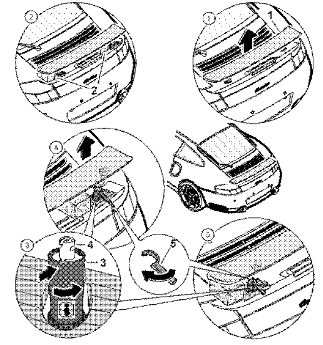

The car is a 1999 C2. A 996tt hydralic wing has been added after market. I have looked at the schematics for 996tt and what I have is identical. The wing does not sit level when at rest or all the way up. I thought maybe it was bolted in unevenly, but that doesn't seem to be it. I read a article about tightening it with a spaner wrench, but schematics don't show anything. I would say its about .5" off level. Thank You

Remove the wing with the spanner wrench and make sure the 14mm bolts are installed properly. The spanner wrench can not tighten the wing. It is either in the locked or unlocked position.
