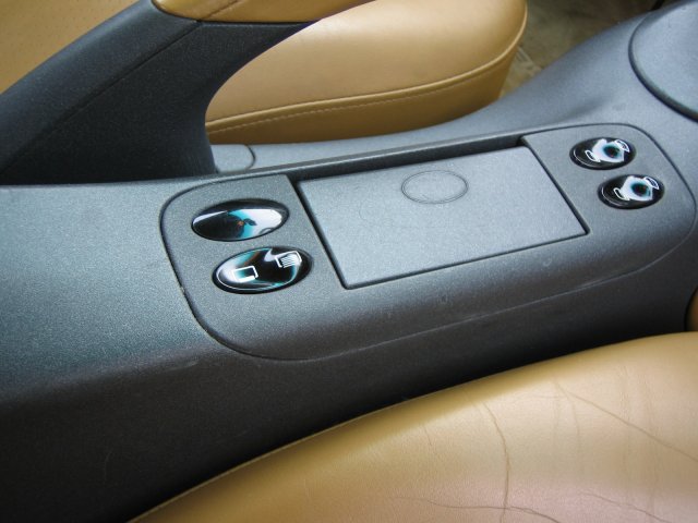

i just wish there was a nice button option for it. im going to go with targa blind even though its matte and im glossy. maybe ill upgrade my swtiches to matte anyways once im done. see if it mutes things a little in a good way.

thanks for the picture richard,
that looks great and much improved over a matte finish in there amongst them. im going to add my OBC switch up top aswell so with it right next to glossy blanks it would have looked even more obvious.
richard,
thanks for that tip. i wasnt looking forward to having an odd switch.
I used a footwell light switch (most non-descript) for mine. mounted it on the open spot below PSM switch. Only functions not avail is the speed gong.
