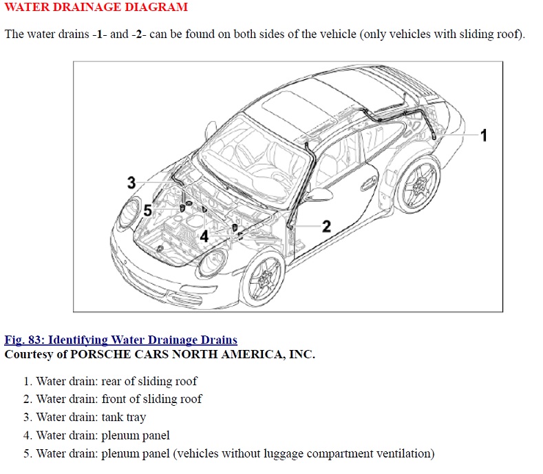

Anyone have a picture of how to access the rear water drain on a 99 911 coupe. I have the diagram, I'm assuming that it is in the rear driverside wheel well towards the back, but I'm just not seeing it? Do I have to remove the wheel?
Any help would be great!

Just downloaded the manuals for 997.2 and attached image of the water drainage diagram.
Yes it looks like the moonroof drain lines are behind the rear wheels
