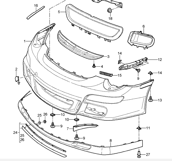

I need help in removing my 997 gt3 front lip. This is the most common part to replace for the 997 gt3
and I need help before removing any of those screws underneath.

After removing the two end screws and the plastic pop rivet, do you just pull, yank, it off? I can't get mine off.
Which way do you pull?
Thanks.
Out (horizontal) away from the bumper. Pulls right off.
