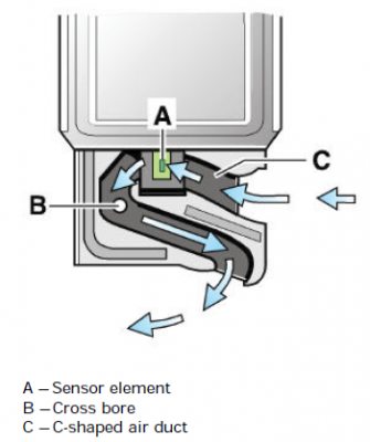

New style sensor (125.00 and 125.01)
The modified hot film air mass flow sensor HFM 5 is used, as was already fitted to the Boxster in model year 2000. With the C-shaped air duct, this air mass flow sensor is more resistant to contamination and water droplets, as these can only reach the sensor element after deflexion. A cross bore through the air duct reduces pulsation faults.
When replacing an old style HMF sensor on vehicles with a new style HMF sensor, you have to reprogram the DME.
