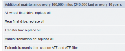

According to the last Additional Maintenance schedule it is at 160,000 miles - so perhaps that is lifetime for most.
