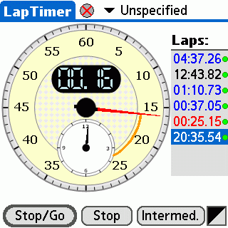

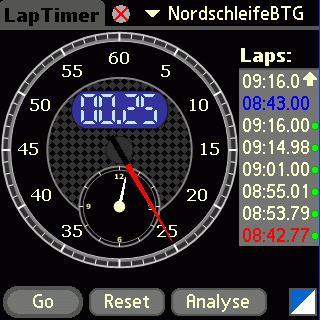

The lap timing software from Germany, it is very cool, go through their website and look at the screen shots. Very easy to use, intuitive, and klutz friendly. I have used it to drive around a neighborhood loop, works perfectly. Will be on track with it next week. Cost for this is $29.
So if you have a new palm, phone or pda, with bluetooth, all you need is the gps receiver and the software and you have a great and simple system to track your lap times, map a course, see the g-forces around the track, acceleration points, brake points, etc. It cost me more since my old Palm M505 is obsolete.
