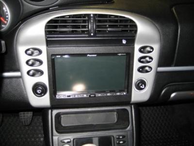

The system is really nice. It allows full use of a 5th generation Ipod 30gig. Added was the high speed Ipod cable. It works great. The stock stereo was removed, the AC/heat controls were relocated to the very bottom of the console. This made room for the Alpine head unit. An upper shelf was added above the AC/Heat control in place of the CD holder.

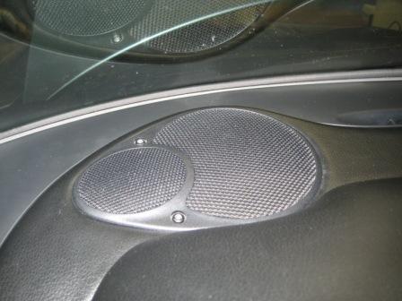

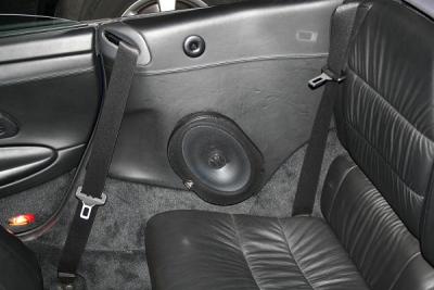

The speakers in the dash and the doors were swaps and made a big difference. The amp provides good clean power. From mids to highs the whole car is crisp. The biggest surprise was added today and that was the Alpine SPC 6x9's. The installer removed the rear speakers and had to cut the existing panel hole a little bigger after the stock speakers/grills were removed. The Alpine 6x9's were fit in using the mounting ring on the outside of the panel thereby extending the speakers out roughly 3/4" from the outer edge of the panel. It was neccesary to do this because the depth of the speaker (roughly 3-1/16") needed this. After everything was installed we tested the sound to see if i needed to run a subwoofer in the front trunk with a vent into the cabin. The Subwoofer was NOT neccesary at all. The sound that I get from the 6x9's is AMAZING!!! The bass is strong and accurate. You can feel it in your chest. Now the sound covers the full gammet. From Lows to highs, it is an extremely high end system that didnt break the bank.
If you want a major sound upgrade that wont change the inside cosmetics of the 996 all that much, this is it! I am extremely happy with the system. Even more happy with the job the dealer/installer did. I live in New Jersey and the firm I used for the project was Zippo's of South Plainfield. Anthony is the manager and he did the install with some assistance from his guys. The whole project cost me $2081.00. That includes; Head unit with nav, 6 speakers and amplifier. All components are Alpine except for the grills on 6x9's which are JL audio. I needed something a little better than the stock Alpine grills because the Alpine grills dont cover the speaker. I have a 7 year old that sits back there and I need the 6x9 speakers in the rear panels covered and Kid proofed...
I would recommend this setup and vendor for anyone who wants a professionally installed system that sounds incredible. You dont need a sub. The 6x9's in the side rear panels add plenty of low end bass for my taste. Its a small cabin. You dont need as much as you think.

This is the exact HU I plan to install in my 99 C2 Cab. Please post pics of the HU and rear speaker installs as I'm very curious on how they made up the trim for the console. Thanks!

Hi, Here are the pics you requested.
Joe D.

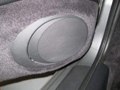

Joe,
Did you have to modify the door openings any? I understand the factory speakers are 5 1/4". Do you have pics of the door & dash speakers as well?

Hi,
I am not sure. When I asked the installer what he put in he doors, he said he put in the 6-1/4". The stock grills are in place and nothing looks modified at all.
JD

I am so glad to help. Its a nice setup. I cannot overemphasize enough the difference the 6x9's made in the back. Monday night I did some spirited (to put it lightly) driving with the top down and the bass stays in the car and sounds amazing. Bruce Springsteen's "Human Touch" sounds unreal.

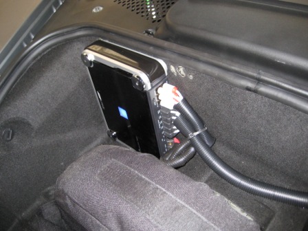

*****UPDATE*****
The Alpine IVA- W505 head unit was installed yesterday. I've had a month or so to live with the existing sound system and I decided that while the car was in, I'd have the system revamped a bit. The additions/replacements were as follows;
IVA 505 replaced the IVA 205.
The 4x150 Alpine power amp replaced the 2x150
I added the imprint processor
I added the Bill Jeuhle subwoofer enclosure with an 8" JL Audio sub.
All work was done as professionally as possible by Anthony @ Zippo's car stereo in South Plainfield NJ.
First let me say, the W505 is light years better then the W205. The Ipod controls are unbelievable. I believe the installer ran the USB connection to the Ipod. The ipod control is so smooth, it almost feels like its not a separate unit. It feels like its part of the 505. The Album art displays on the screen nicely. The touch screen is better than the 205's in the sense that it reacts quicker and more positively to the touch. The bluetooth connects to my phone without a glitch and using it is a real treat. Moving from screen to screen is flawless. The whole system has a much more "professional" feel to it. The installer tuned the system with the imprint unit. The processor has made the stereo sound as if its not installed in the inside of a little Porsche anymore. The soundstage is big and the music is well centered, fuller and even more accurate than before. Its unbelieveable. Alpine has listened to the consumer and put together a top-notch system. It even has 4 different screen colors to match the interior of most cars. (Amber, Magenta, Blue and Green).
The subwoofer enclosure is JUST what the car needed. The molded plastic box comes barebones from Bill Juehle (billjehle.com). My installer carpeted the outside and sprayed the grill black. He fitted the box into the front passenger footwell and bolted it down. He installed a JLAudio 8" sub. It sounds WAY bigger than any 8" I've ever heard. Probably because the interior is so small. Trust me, you dont need any more than this 8" in the Porsche. The car now has bottom end in the sound. The fullness is incredible. The accuracy of the sound is great. No distortion, buzzing or false artifacts in the sound. Just clean fullness, with crisp highs and pounding (yes, Pounding) lows.
In order to power the sub, my Installer had to change the 2x150 amp to the Alpine 4x150. What a difference that made. The clarity and power are amazing. The gain is only at the halfway point. My installer recommended this because he felt it would provide the cleanest power obtainable, while running very cool in the process.

I just finshed my stereo system upgrade in my 996 cab.
Here's what I installed...
> Avic Z3

> FOCAL K2 Power 13 KS 5" Subwoofers in doors
> FOCAL K2 Power 100 KP 4" component speakers for dash
> Hertz HCX 100 4" coaxial speakers in rear
I didn't cut any new holes in the car just used the existing speaker holes and grills. Even re-used the stock woofer enclosures that are embedded each door.
