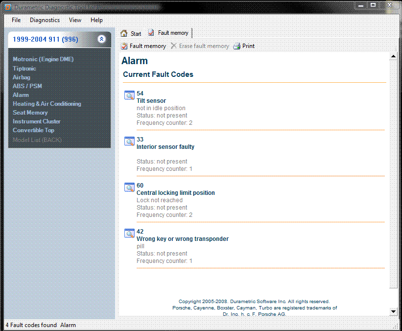

My alarm has been periodically going off on it's own. I bought a durametric scanner and it showed a number of alarm faults.
I'm not sure what some of them mean like 54, 60, can anyone assist?
54 - Tilt Sensor: not in idle position
33 - Interior Sensor Faulty (this one is obvious)
60 - Central lock limit position: lock not reached
42 - Wrong key or wrong transponder: pill (this is odd since both of my keys are definitely coded to the car and function fine.

Thank you Loren-
Odd that the 54 error says 'tilt sensor' on the scanner, but it is in fact for the radio? I did swap mine out for an aftermarket nav.
Guess I will start with replacing the interior sensor and go from there, does that sound reasonable? Hopefully that is an individually purchasable part.
That sounds like a logical plan.
