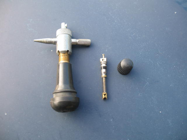

Anybody know the thread size on the valve stems? I crossthreaded the tire inflation pump, need to clean up the threads. I believe it's a std shrader valve, but can't seem to find a tap anywhere?
As far as i remember is the outer thread size of a tyre valve stem 8.00 x 0.80 mm. Go to a tyre center, they have a special tool to rectify the outer and inner thread.
Indeed that's the tool, looks unused to me Tool Pants !!
