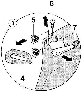

Hey Loren,
How does this piece come off? Please don't tell me I have to remove the seats and take the seat
belts out.. I have a feeling this is what I need to do..
Here is the piece
Loren, the seat belt actually goes through this piece so does the one end of the seat belt have to come off in order to get it through?
Eric.. painted or replace with black.. I don't think it comes in Carbon..
Yes. If you follow the belt down to the carpet there is a large bolt under a plastic cap. Remove the plastic cap and then remove the bolt (remember the order of any washers or spacers). This should allow you to manipulate the belt through the rose.
