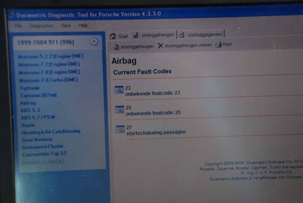

Airbag light popped on (996 02Tip). Can't reset it with my durametric software. Faultcodes are: 23, 25 and 27, any idea?
Thanks! :renntech:
Regards,
Sebastian
Fault 23 Driver's seat belt tensioner Fault memory/warning light
Fault 25 Passenger's seat belt tensioner Fault memory/warning light
Fault 27 Ignition circuit, passenger Fault memory/warning light

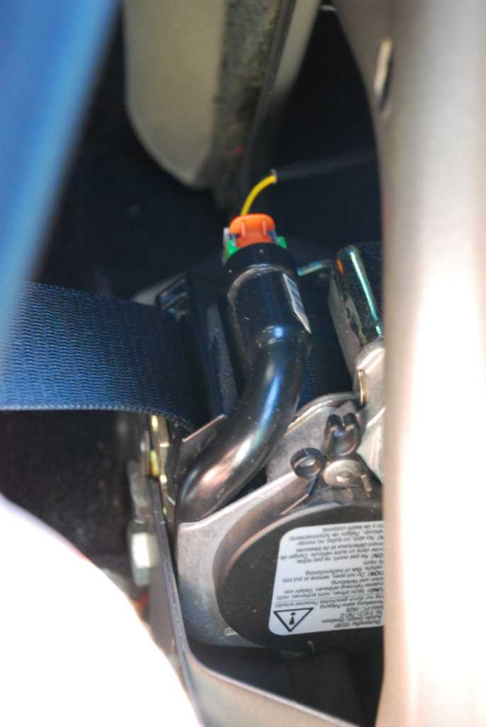

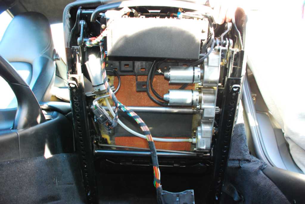

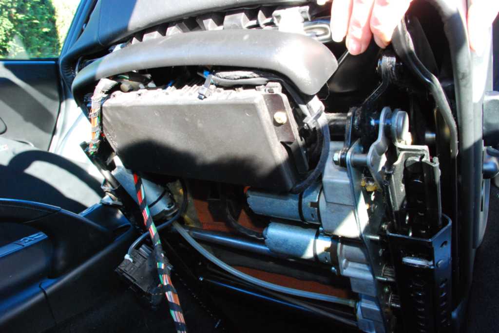

Hi Loren,
It took things apart today. Seems that the correct seatbelts are in place (with wire). All is connected as it should be, at least so it would seem so to me. Only thing I can't figure out is where the heck the seatbelt pyrotechnic wire goes to..
I've attached some pictures from the seatbelt wire and the wires under the drivers seat. There's a lot diffents wires there, not sure what to check. Allso ground seems good, no corrosion, tested it with a multimeter to the chassis and got 0 Ohms..
I can delete the airbag faultcodes, but they return in no more then 2 seconds.
Could it be that the pyrotechnic belt tentioners have gone off (accident) and were not replaced? Any way to check that?
Any other ideas?
Edited by doubleb
You need a PIWIS tester to pinpoint the problem, by the way using a multimeter on airbag systems is dangerous, the battery inside the meter can let explode the modules ( meter in Ohm possition ).
If you can find someone with a PST2 or PIWIS have them check the exact coding for the seat belts. They should be coded as "active".
If that is not it then either both seat belts are bad (not likely) or the airbag control unit may be bad.
