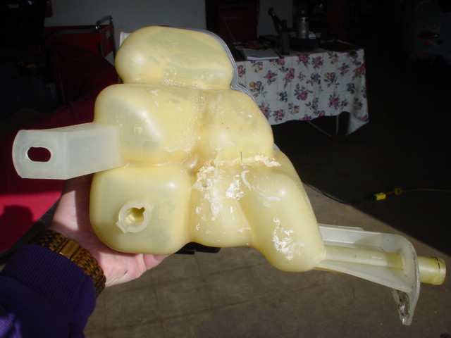

Keep a close eye on it anyway, there may be other weak spots... After removing my tank I found a smaller 2nd leak, and 3 more in the process.
On my old tank there was a small failure along the seam between the black 'top half' and the translucent 'bottom half', the epoxy must have failed under the pressure and heat. The other areas were mid-tank, on the backside, unviewable from the trunk space without removal... The three weakened areas were dark brown, almost black, with noticeable spider vein cracks running throughout. The 1st and 2nd were at the junction of two of the 'lobes' of the tank you see on the outboard side. I assume the junctions we're not made thick enough to stand the pressure and heat either. The last defect (leaking) looked the same, but was in the middle of a flat area of the plastic... a little scary.
The tank I put in (Apr '05) was the 9th version (.09) porsche has introduced. Nine tanks in 7 years!

From my experience, the fact you haven't noticed coolant on your garage floor isn't surprising. When the tank fails, the coolant loss is immediate and dramatic. By the time I got my '99 home (less than 5 miles) there was barely a trickle coming from the bottom of the car.
This is what I did and it seemed to help pinpoint the problem..
- Remove your engine cover
- Remove all carpet (and the black styrofoam liner underneath) from the trunk.
- Refill your tank to spec with the coolant and water @ 50/50
- Install the new (.01) cap. You'll want it anyway
- Start you car and park it on a level surface
- Bring the car to temperature
- Run it for at least 20 minutes to build pressure
Look for either; coolant dripping from the bottom side of the tank, or escaping from a compromised hose in the engine compartment.
When coolant gets on the trunk floor it drains down through a small hole and ends up dripping off the right rear jacking point. If the leak had been small for some time, you may not have noticed a few drips in front of the tire and the styrofoam insert prevents it from staining the carpet. Coolant usually takes some time to evaporate, but if temperatures have been as high as you say, and your don't spend much time on the passenger side, you probably wouldn't have noticed. When the coolant dried next to my car, there was almost no residue.
