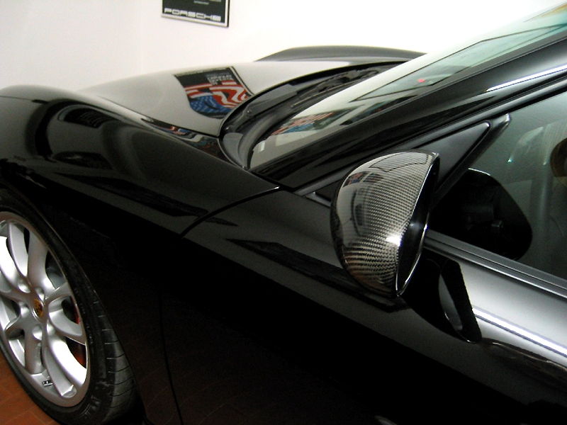

I fitted the wing mirrors with no problems. Thanks for your help. I was up at the garage getting the rear spoiler when its sister car turned up....
