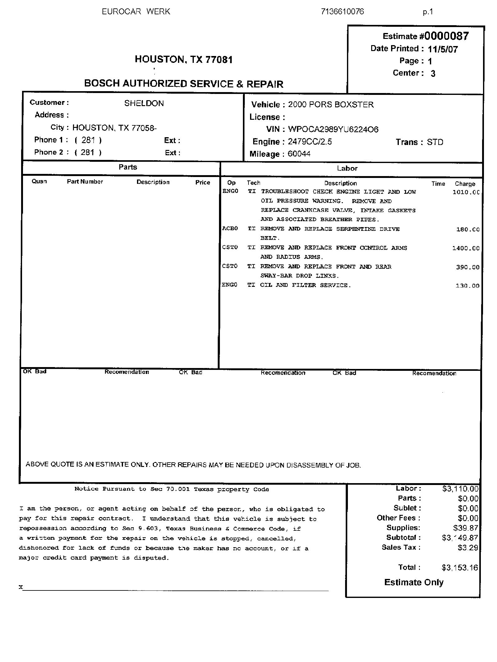

Ok, can anyone give me their opinion concerning the attached quote? I purchased my Porsche in Oct 2006 with 51K. It currently just has over 60K on the clock. Since I first got it I have noticed that the suspension has gotten worse, they CEL engine keeps on coming on and my ignition switch seems to be acting up, or so I think. When I spoke to the mechanic about the starting problem, he basically said that it is not always the ignition switch that is causing the starting problem. Sometimes I have to hold the key in the start position until it finally turns. Sometimes it starts after 2 seconds, sometimes after 30 seconds, and sometimes longer. Apparently the immobilizer is the key culprit. Has anyone ever heard of this before?
Also, after time I noticed that the front end would vibrate a lot and the steering shock viciously when in a slight turn between a certain speeds. Now I would never expect the following problems with a vehicle with 60K, unless I am so wrong about Porsche. Then another problem arose when my oil light would flash intermittently when at idle and a screeching sound would come from the engine area. I took it to the mechanic and take a look at the attachment to see what I was slapped with.
Has anyone had this much luck with 60K on the clock?
Why aren't the parts listed and the cost of the parts spelled out separately?
Go to another shop. That is way out of line
