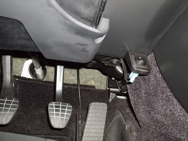

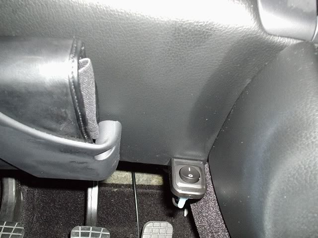

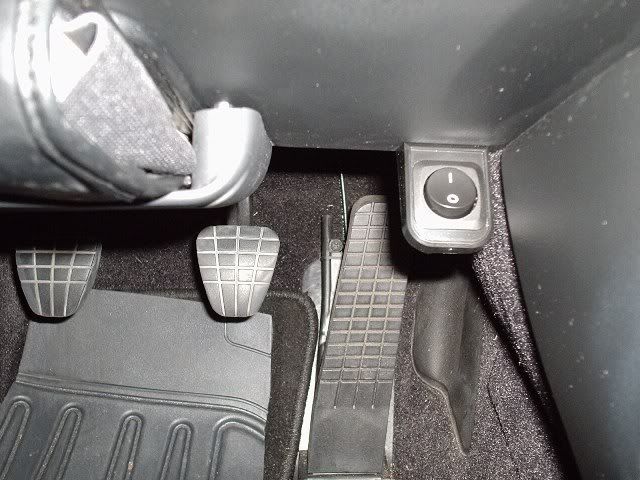

Best of both worlds - I bought a switch at Radio Shack (P/N 275-730). Hold the bracket up to the
bottom of the dash, as far forward as it will go and hard against the driver's side of the console.
Drill 2 very small pilot holes through the places provided on the bracket. Install and tighten the
2 supplied self-tapping screws. Snap the switch in the bracket.
This is very sturdy, very out-of-the-way and matches the other dash switchgear well. The switch
has a positive feel and is rated at 25 amps (way much!). there are large male spades on the back.
Run your DRL hack wire through the switch........You can then allow the DRL hack to function, or return to
regular mode "at the flip of a switch".
I had to get down pretty low to take these pictures. You don't even normally see the front of the switch (you
would have to be looking for it), let alone the back or the wiring. Still, it's easy to slide your hand down and hit
the button (rocker). Your feet or knees won't even get within 8" of it.
