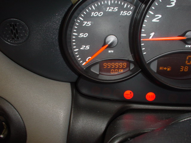

The difference between 599,999 or 999,999 is if the display is in the miles or kilometers mode. My 999,999 picture is kilometers.
Put the key in the ignition. Disconnect the battery negative cable. Turn the key to position 1. Then tun the key to the off position. Then hook up the battery cable. The display should be back to normal. You may have to twist the knob to change between US and metric miles.

THANKS IT WORKED!!!!!! The odometer and all the dash settings came back by disconnecting the negative cable as suggested. The radio has no power so I am after the fuse fix ...hopefully the radio will not have to come out. I have the card with the code ....shouldn t that work or is it rest set everytime it comes out? Then onto the airbag.
