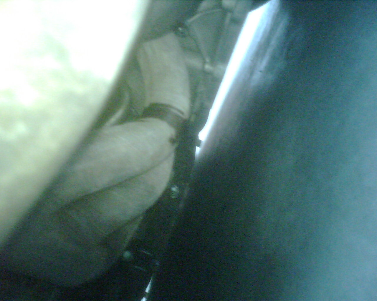

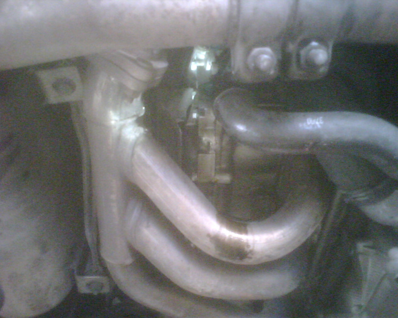

So he resealed the cam cover and everything was bone dry under the car.I drove it to work the next day (50 miles) and when i parked i could see smoke coming from the rear and a lot of oil dripping onto the exhaust. I took it to a shop nearby. They put the car in the air and checked. The oil leak was from the upper cam plug which is above the exhaust pipe. It was dripping on the hot exhaust and burning up and you could smell it. See attached pictures. The cam cover was dry. I told them that I had just got the cam re-sealed. They told me that who ever did the cam cover didnt do a good job and they clogged / blocked the oil tubes in the process of sealing it. They said that was creating pressure on the cam and oil tubes and thats why the cam plug is leaking. They said if creates a lot of pressure its going to blow out the cam plug. They said to fix it they would have to take out the cam cover again and re-seal the cam cover all over again and clean the oil tubes. And that would stop the oil leak. They told me my best bet is to take it back to my guy and have him re-seal it.

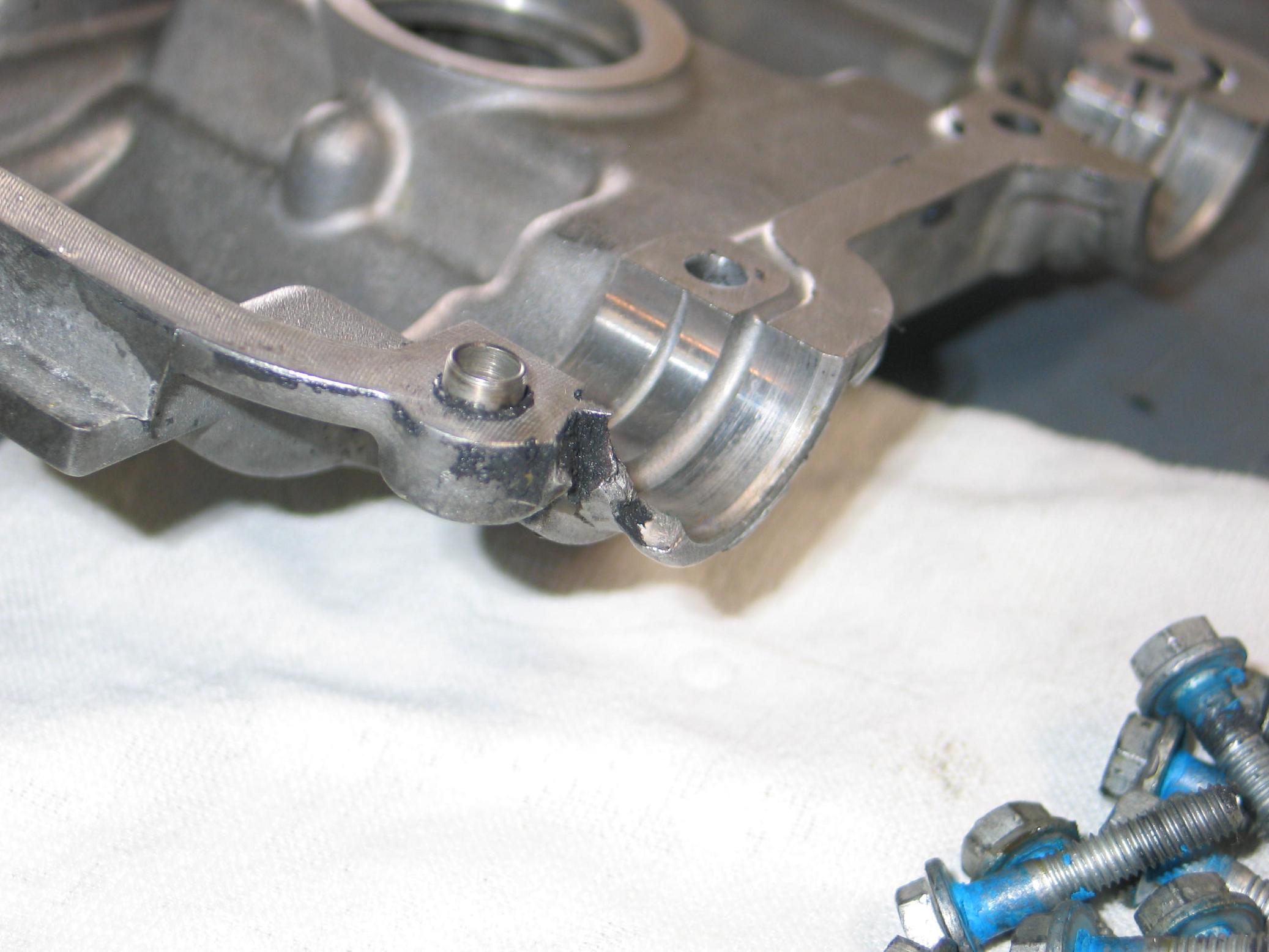

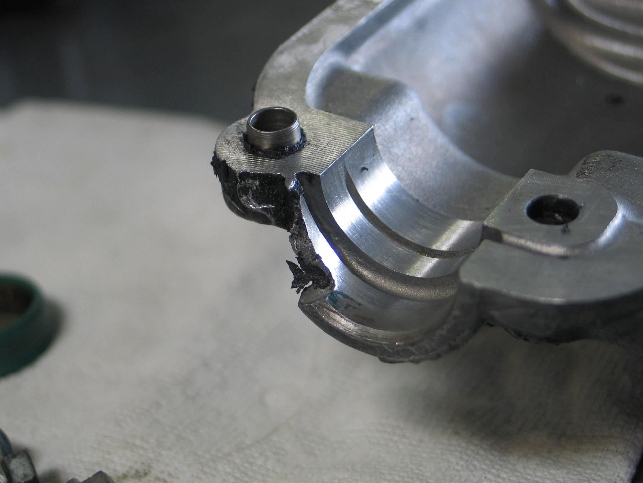

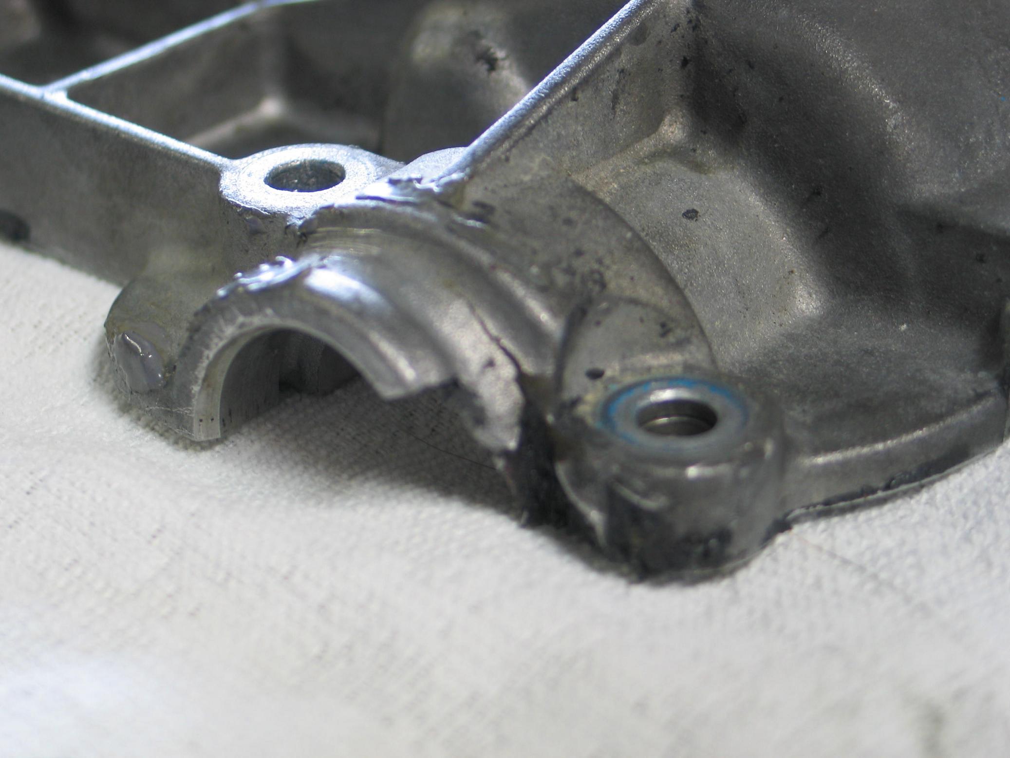

I had the cam cover taken out and it turned out that I had a crack where the upper cam plug fits. The crack is on the cam cover and not the cylinder head. I might have to replace the cam cover and the cylinder head which is going to cost a lot of $$$. My mechanic is looking into other options that might work.
That is a very odd problem. What did the crack look like? hairline or did it look like something hit it?
The head and cam cover a machined matched set - so both have to be replaced.
A chunk of piece is missing. It looks like it hit the body. Attached are pictures. Does anyone have a estimate how much it would cost to get the head and cam cover replaced?
Hmm... it does look like something struck it to me.
I would take it to the best machine shop in town and ask if they can re-weld and machine the damage.
