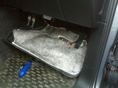

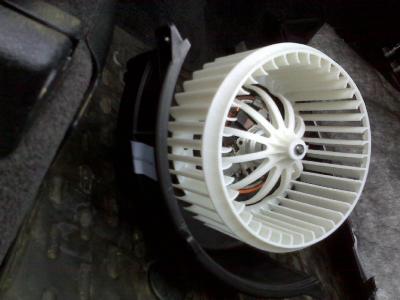

I replaced the AIRCON fan yesterday ($165) I thought it was going to be straight forward and it was except for 1 PIA screw (as usual) but it fixed the noise (a lot of crickets singing) now I can be warm again.
Thanks guys
Sorry for the quality of the pix, camera phone I'm afraid, being to lazy to break out the good one.
Mike

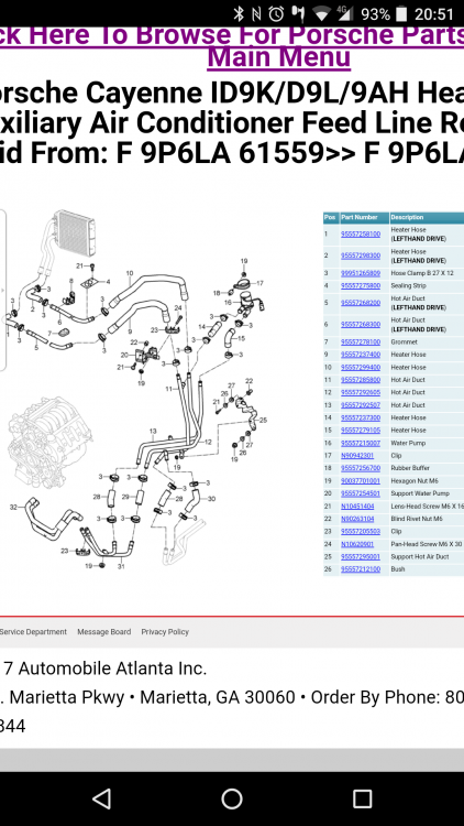

Many times a buzzing from the HVAC fan is because of either some leaves have fallen into the cowl air intake on the passenger side of the vehicle in the front engine or trunk area, or more likely on older cars like 996/997/986/987s is that the foam inside the HVAC blower box has started to deteriorate and a piece of foam is now rubbing on the fan.  You can easily access this area where the fan is, by removing to cow plastic covering the cabin filter, removing the cabin filter and cleaning out all of the stuff that has collected in the fan area.
The buzzing noise is likely the auxiliary water pump item 16, (not sure your model year or options though).
It's mounted behind the left driver side Wheel arc cover.
Fan on is the signal for the pump to run if calling for heat. It may be coolant temp dependant as well but not sure hence won't make noise if engine cold?
