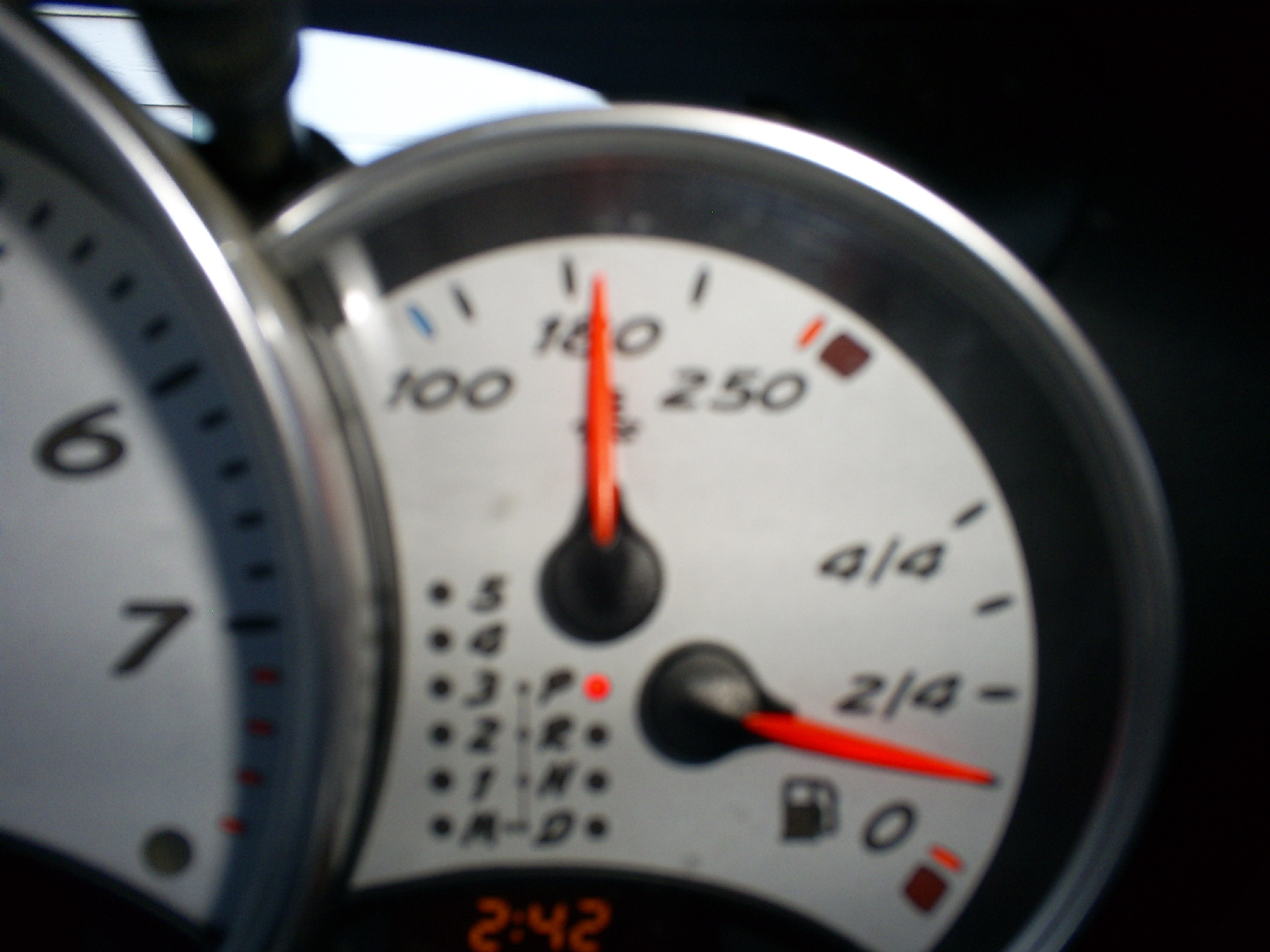

I have a UK Box 986 2.5. I have noticed that the needle on the temp gauge moves quite far over, especially in start-stop traffic - as soon as I drive for a few minutes at a reasonable speed the needle slowly moves back. In motorway driving it stays just left of centre, but in heavy traffic it moves almost beyond the '0' in the '80' inscription of the temp gauge. Is this normal?

It cant be over heating and the fans are working of the Needle doesnt go past the "0", somewhere over the "0" is when the fans turn on. I've sat in my car and let the temps climb and somewhere over the "0" i hear the fans trigger and the needle drop slightly then the fans turn back off and the needle climbs again and so on and so on.
Its normal in heavy traffic for the needle to go up to the "0". Might want to do a coolant service if you havent done one yet to help keep the temps as low as they can be.

Folks if the needle is straight up on the gauge - that is normal.
That is the way Porsche has designed it's gauges for years (even the race cars had the tach rotated so that max RPM was straight up and down).
for a 2.5 the needle should be straight up for normal highway driving. In stop and go traffic, the needle will move into the 0. After the half way point of the 0, the fans should turn on and work its way back down. In stop and go I've had my need on the far right of the 0. Only under heavy track use does the needle move past the 0.
the line between 180 and 250 is supposed to represent 220. Anyway years back 250 was too hot. Now with the thinner oils the temp can get closer to that number without the oil breaking down.
250 is still really really hot but i think that if you are closer to 220 you really don't have anything to worry about. Just make sure all your fans are working and that you have cleaned out your radiators.
