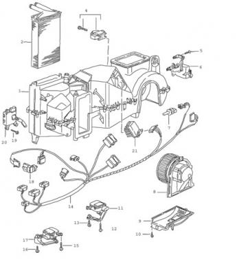

The fan ("blower motor") that blows either hot or cold air into the cabin is located under the dashboard, at the passenger's (right) side.
Here is a diagram of the blower motor (part #8) and its housing, along with the heater core (part #2), through which hot coolant must flow, to produce hot air into the cabin:
Please clarify whether, when you put your heater blower speed at the highest setting, you get a lot of air blowing through the vents, except that the air is cold, and whether, when you lower the blower speed setting, less air is blowing through the vents.

Thanks for the diagrams of the blower motor (part #8) and its housing, along with the heater core (part #2). Should I be checking these parts for anything?

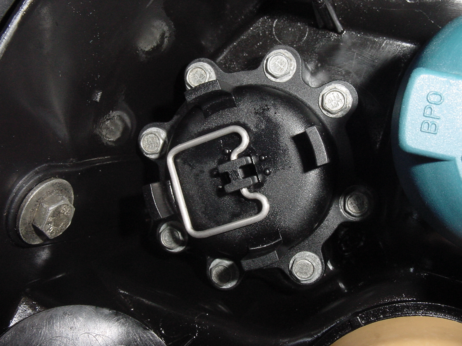

Since your blower motor is blowing, no need to worry about that part for now. Since you don't have any antifreeze odor (or fumes/coating on the inside of the windshield) then your heater core (which is just a very small radiator) is probably not leaking, so it should be okay too.
From what you have described above, it's possible that you had air somehow trapped in your coolant and, as a result, the heated coolant was not circulating properly throughout the cooling system, and thus not circulating through the heater core. That would explain why the air was not as hot as you are accustomed to getting.
Check the level in your coolant reservoir, and also maybe bleed the system. A good (and easy) way to start is to simply lift the bleeder valve lever, which is located under the thin black plastic cover on top of the reservoir tank. Here is a photo of the bleed valve and lever:
You can see the lever's straight metal portion on the left side of the photo, which is the one opposite the "S-shaped" portion. That's the part you lift up, with the S-shaped part remaining in contact with the top of the plastic assembly.
You can drive around for 30 or 40 minutes with the lever in the up (vertical) position, and then simply flip it back down. Be sure to check your coolant level again after the car has cooled down for a few hours. If you find that the level dropped, you have most likely hit on the solution to your lack of heat problem.
Do not open the coolant fill cap while the engine is hot, you could get scalded. Put a rag over the cap as you are unscrewing it for extra safety. If it's less than a quart or two, you can just top it up with straight distilled water.

This sounds all good and I am familiar with what your saying. Pedro, who you may know on PPBB showed me this procedure at West Coast Boxsterfest last October 2007. Because I had some coolant spill out from the high altitude in Tahoe. The coolant expanded/over flowed by the time I reached my final destination in Tahoe. Probably too much coolant in tank then. So Pedro had me fill up the coolant tank with distilled water and then show me how to purge it to get the air bubbles out. Plus he showed me how to turn off the CEL, because it was lit from the spill.
So probably I had a air bubble in the coolant like you said. That possibly explains the cool air then the hot air. Good job Maurice. But I will still keep my eye on things. I appreciate all your efforts to explain all of this to me. I learned a lot from both you and juniiuc.
