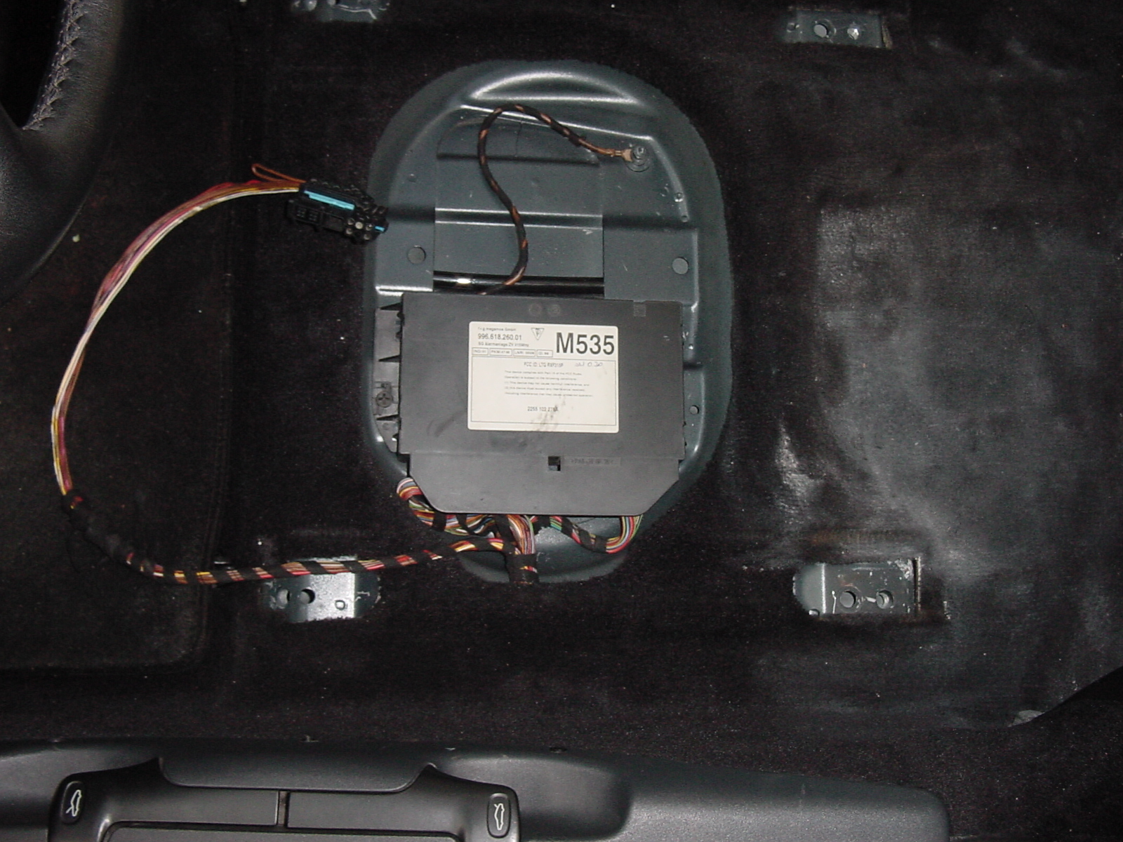

hello all i have checked the fuses & when i was checking pulled a fuse out of row C fuse 3 which is for the Central locking/alarm system power windows & inside lights then the noise stops . car still doesnt run correctly with fuse out .
Does anybody know whats located under the trim of the bonnet & boot lever ?

It's coming from your arlarm module
dont even mess with the hood release!
Edited by juniinc
sorry to tell U,but it is your alarm control module!
U think its coming from the hood release lever, because M535 is located right next to it(a few inches apart)!

Nope, alarm module is pretty big it will never fit under the lever, under the seat.

Matt:
Here is a photo of the central alarm control module:
Note that the seat has been removed for this photo, and for reference, you can see the two levers at the bottom of the photo. (Click on the photo to blow it up).
On U.S. cars it is located under the left seat. Since you say that the buzzing is near the two latches that release the front hood ("bonnet") and the rear trunk lid ("boot"), then it is probably under the right seat. If you don't see it there, check under the left seat.

If u are removing the seat, try not to unplug the wiring hardness.
u should have enough wire slack to rest your seat out side.
The lever lock electro motor is located under the trim.

RFM is referring to the two solenoids that lock the front and rear latches when you lock the car.
I guess if one of these solenoids is bad it might make a buzzing sound.
