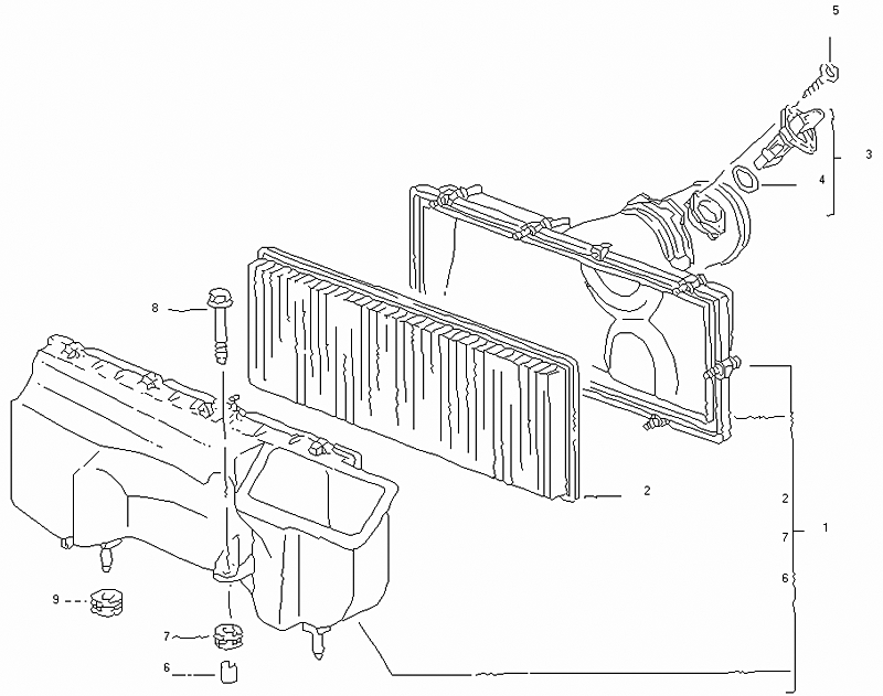

would you get more air if that airbox modify to fit a 3.4L?
No. The whole system (airbox, intake manifold, variable cam timing, exhaust) is finely tuned in terms of resonance frequencies and gas dynamics (open and closed end reflections). If you change one thing, you are likely to screw up the system.

looks pretty easy to rebuild this one, need only to rebuild the cover portion so the cold air-intake fits to the original hood.
but what that in picture shows under the MAF tube, is there another hole?
another thing what is the depth of the box and appr. cost?
