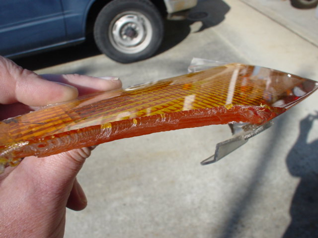

Did the mod today. Burnt out the plastic with the solder iron; that is tough stuff, not very pliable. You'd think plastic would snap if twisted? Take your time, as it takes patience to melt and then grab quickly with needle nose pliers. The stuff hardens almost immediately after being heated! I was more than happy to rid my '02 S of this last remnant of amber. The silver bulbs look and work great. BTW, I used mulitple layers of aluminium foil and had very little damage around the light socket. I touched it up with a file and it is not visible. The socket plug has enough tolerence in it that it would not affect replacement anyway.

On a 2003 the internal lense is amber with a clear bulb, just like litronic headlights. If you remove the lense then you would need amber bulbs or the silver bulbs that flash amber.

Before and after pic. Left with the orange filter present. Right after it is removed.

Please note that, as Jeff points out, this only applies to headlights with the orange filter insert. Not to those with the orange coating underneath the outside plastic.
