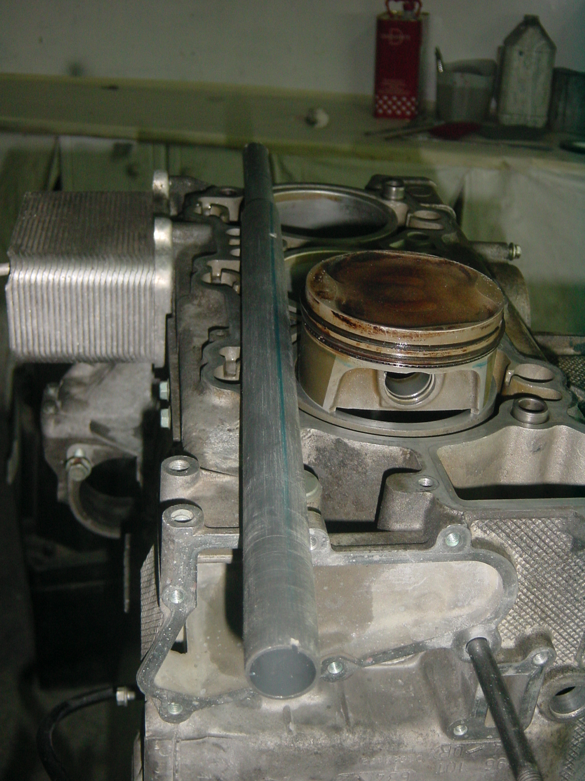

I did the rebuilding of a 3.4 engine by myself. I have no previous experience on those things, but had the Porsche workshopmanual. Without it it would have been impossible to do it.
The only "special" tool required was a home made piston circlip installation tool, which I made from two plastic tubes. See attached picture. I cannot remembre the diameters of the tubes, but I think the bigger one was about 3/4", and the inside one was just able to slide inside. I had to sand away a bit for the exterior tube for it to enter the piston installation hole.
I looked the exact position of the circlip, and made a blue line into the "installation tool" to be able to line it correctly to the piston. The small cut you can see in the exterior tube is where the circlip´s hook has to be placed. It was a bit problematic to put the circlip inside, but I found out that even it was not completely perpendicular to the tube, it went into it´s place without problems. Just a light hit to the inner tube, and the circlip went into. Just press the exterior tube tightly against the piston.
I was surprised how easy it was,in the end, after months of investigation how in heaven I´m going to get the circlips in....
When I opened the engine, I removed the cams together with the variocam unit, so here was no need to adjust them. The chains were OK. I also made a small thing to hold the cams inplace when the valve cover was removed.
Otherwise there were no big issues...
Saludos
Kare

Thanks for the insight. I see the picture of your tool, the pipe in a pipe however can you explain a little more, how exactly do you use it? Can you define the "circlip"? And finally where does one acquire a "shopmanual"?

The circlip is a metallic ring keeping the piston pin (connects connection rod and piston together) on its place . To use the installation tool,first line the connectig rod with the instalation hole,install the piston and insert the piston pin. The circlip is placed inside the outer installation tool tube,with the hook inside the cut.
The tube is then pressed tightly against the piston, lining the installation tools blue line with the piston´s circlip opening. Then a firm hit into the iner tube to install the circlip.
I bought my shopmanual from Ebay, however it was an illegal copy. Porsche sells the legal copies, but with very hefty price. Send me a PM, maybe I could help you.
