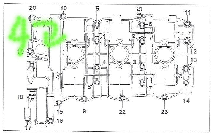

Is this right? The special tool is to hold the cams in place because they are vertically secured in a boxer engine, right? So would I need two such clamps then (at two different spots along the length of the camshaft)? The factory manual seems to use quite a few different ones. Or can we rely on the tool to be block (rather than a plate) and thus its 3D shape would hold the cams temporarily? I was thinking about fabricating my own "special tool", but it would be a plate, not a block....

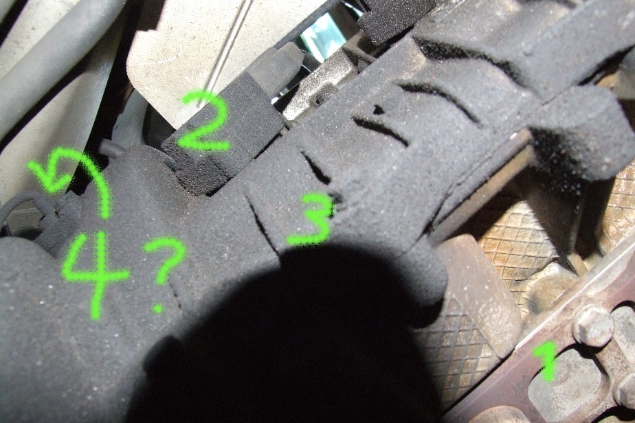

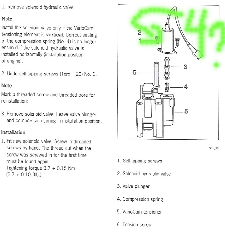

Anyway, this could just be wishful thinking here. From a previous post by Paul Fraser, (http://www.renntech.org/forums/index.php?showtopic=4190&hl=p0303) he had the variocam solenoid replaced for 322 pounds (including parts?), which, given the UK cost of living, is not a lot of money. This leads me to think it might just be possible to do this without taking apart everything. On close inspection, I can't figure out what No.4 is? It would seem to be where the variocam solenoid housing mounts to the cam cover. If that's the case, when you look at the exploding diagram of the solenoid/actuator assembly, it would seem that the external housing is in fact the actual solenoid. So then, can't I just remove that directly from the cam cover without removing anything else at all? Or have I got the wrong part and the No.4 in the photo is not No.4 in the diagrams at all?
