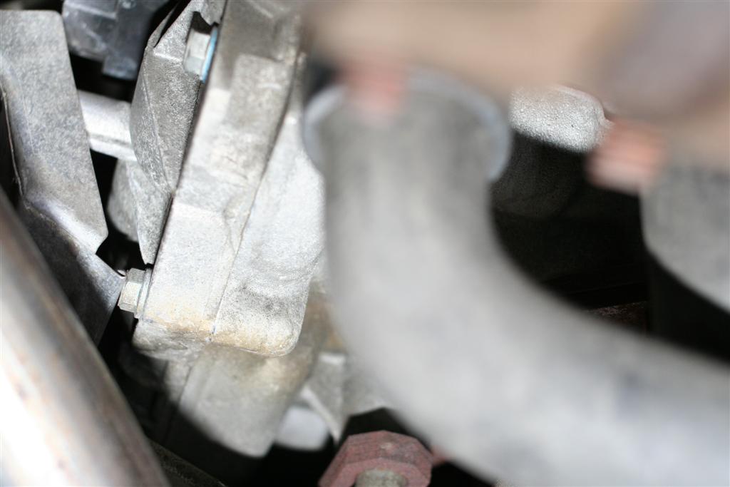

I have an '03 C2 and I can't wiggle out the driver's side heat shield. I tried to slide it out toward the front of the car but it keeps catching on the rear boss which it screws to. I've already flex it as much as I can but it's still stuck in there.

Thanks, Loren. I have stock exhaust. Seems like the shield is caught between the exhaust can mount (the mount that bolts onto the engine with multiple "legs" and it has 3 holes for the 3 studs on the exhaust can) and the engine. So even removing the exhaust won't help.
Can you confirm at least the shield comes out toward the front?
In the photo (looking up from the driver's side exhaust), you can see the shield on the top left is catching the boss it's screwed onto.

Ahsai, I had the same problme this weekend doing my spark plugs, 03 C2. I ended up bending the rear side of the shield to get it out. It is just sheetmetal, bends back up after re-install. The passenger side did come right out....

Ok, I just wiggled it out...it took some twisting :)

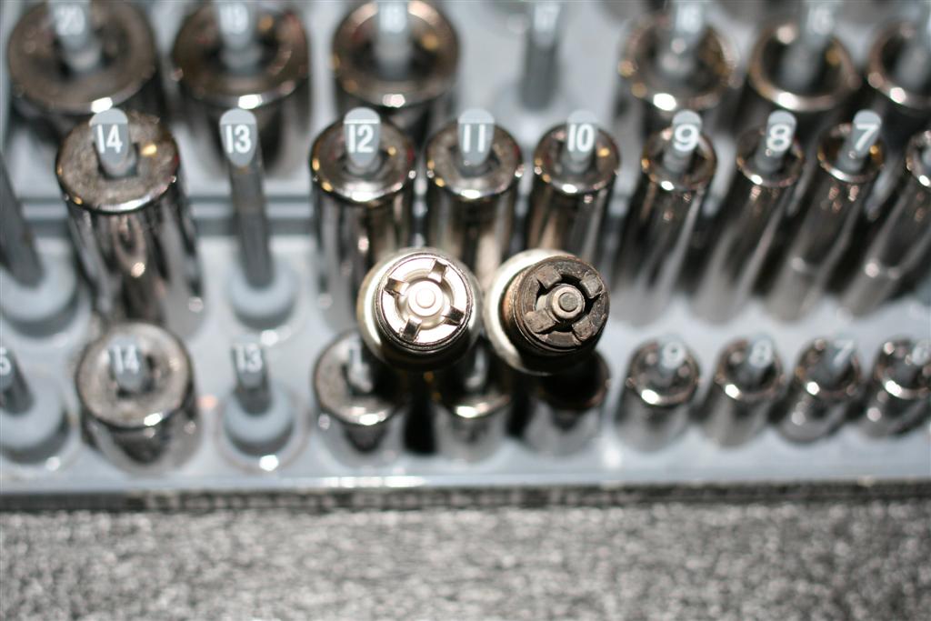

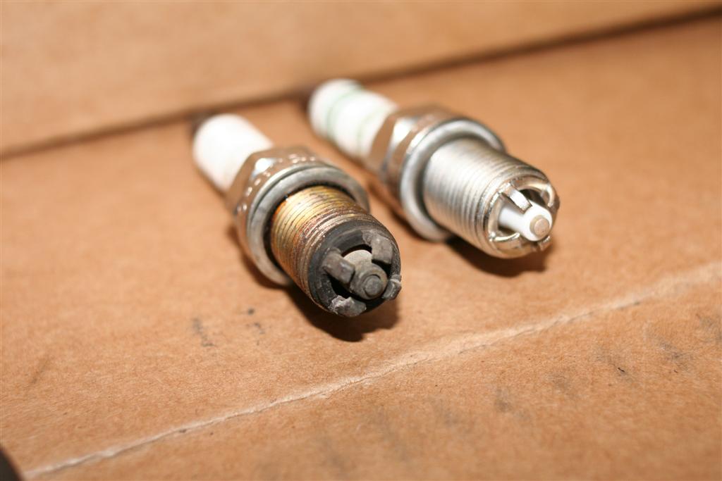

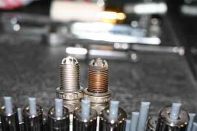

After a lot of cursing and cuts on the hands, finally have it all done. Here are some pics of the old vs new plugs.
The old plugs have only 26k miles on it but they seem to have worn out quite a bit.

Only one concern the pict to the far right the new plug seems to have an out of alignment ground electrode. The good news is the old plugs seem to have the correct burn color, and they do not seem to tbe that worn at all!
Funny, that's exactly what I was thinking. The old plugs look great! Hey, but I REALLY like that socket set & holder..anyone know what it is? As far as the 996TT, use the recommended plug.

The wear is very obvious when compared side by side with the new plug. Doesn'[t show well in the photo. The new plugs make the engine smoother for sure. The sockets and holder (made by Hansen) are both from Sears.
