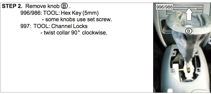

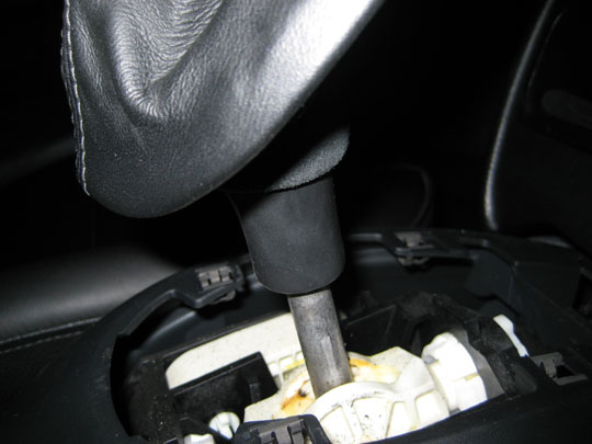

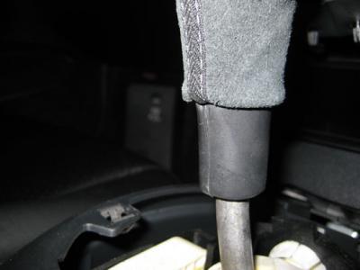

Today, I decided to go for the B&M short shifter install. The directions (with the kit and online PDF) seemed relatively straightforward, so I decided to dig in. However, I couldn't even make it past step 2, which is the removal of the knob. The directions indicate that I should be using a hex key and/or loosening a set screw, but I see nothing of the sort. Instead, there is a black plastic collar (approximately 2") that extends down from inside of the knob, over the shifter. Images attached. Am I missing something obvious? I don't want to pull too hard and/or break something in the process.

I'm not sure that I can help. This is the first time that I've contributed. But, I did put a short shifter on my 02 C4S a few years ago. I also had issues removing the shifter. I didn't want to damage anything, so I was pretty nervous. After reading the same instructions that you most likely got off this site, I tried to find a screw to loosen the shifter. After talking to a few people, I found out that the basic shifter does not have a screw. It is secured purely by friction. So, one night I tried to just pull the thing off. Though it took a lot of effort, it finally pull off with no issues. I've since sold the car, but it's still listed on Luxury Motors' web-site. So, I've down-loaded a picture of the shifter that I had (see attached). So, if it looks like this one, I can attest that it just pulls off.

hi, i had the same problem when i did mine. the shifter is a press fit, it will come off with some (alot) upward force and a little wiggle action. another trick is with the b&m shifter or other makes dont disconnect cables like the directions say, you can turn the whole assembly over and disconnect the cables, this way you wont upset the cable dimensions. one other thing to is be careful with your leather brake handle it is very easy to tear on the sharp edges of the center console when removing. hope this helps
Try using search feature. ;) There are many posting on the subject. Below is a link to one that basically tells you that all you need to do is pull hard. I have read another post that suggested using two wrenches to sandwich the shaft just below the knob and pull up. Better leverage.
