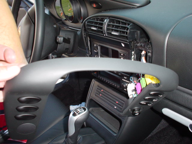

I need to remove the trim piece around the radio - a/c as one button needs to be put back. I looked and no screws, do I need to pry it out? Is there a special tool to remove it? How about the wiper dial, doesn't need to come out first? Thanks
Edited by porschenut
Pry out the trim piece with a flat screwdriver starting left or right under, disconnect the switches when the trim is out, the wiring is long enough.
It just prys out. There are plastic prongs on the back of the trim piece that go into metal clips - a simple friction fit. The snap together car.
