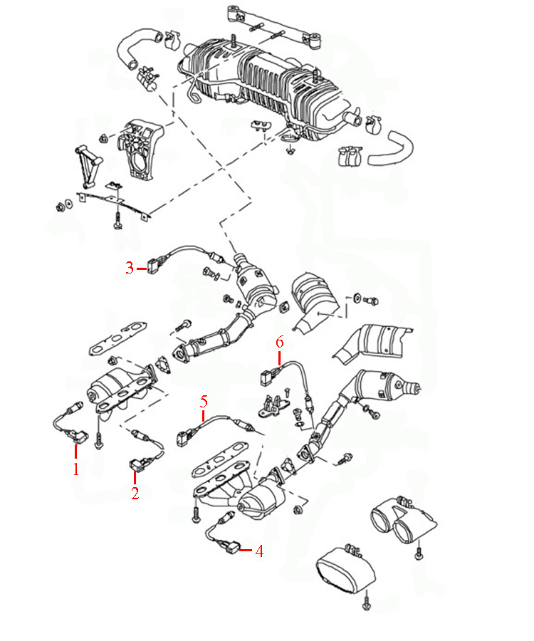

hi guys, i have a 2000 boxster s and i need some help with identifying the oxygen sensor that i need for error code p1276 and p0153. i have done some research on this topic and have came up with few threads covering this but still a little confused. the confusion is this error code indicates a bad O2 sensor at bank 2 sensor 1, which is on the driver side before the cat converter (number 1 in the diagram below). and the parts number someone has posted is bosch 13806 which is for a post cat sensor. so i just need someone to clear this up before i purchase the parts. please help. thank you all.
ps. please let me know the number in the diagram below.

hey loren, thank so much for your advise and help. i'll try that first before i order the o2 sensor. but can you tell me from my diagram which o2 sensor is the 1 i need? i'll let you know what i find. thanks again.
