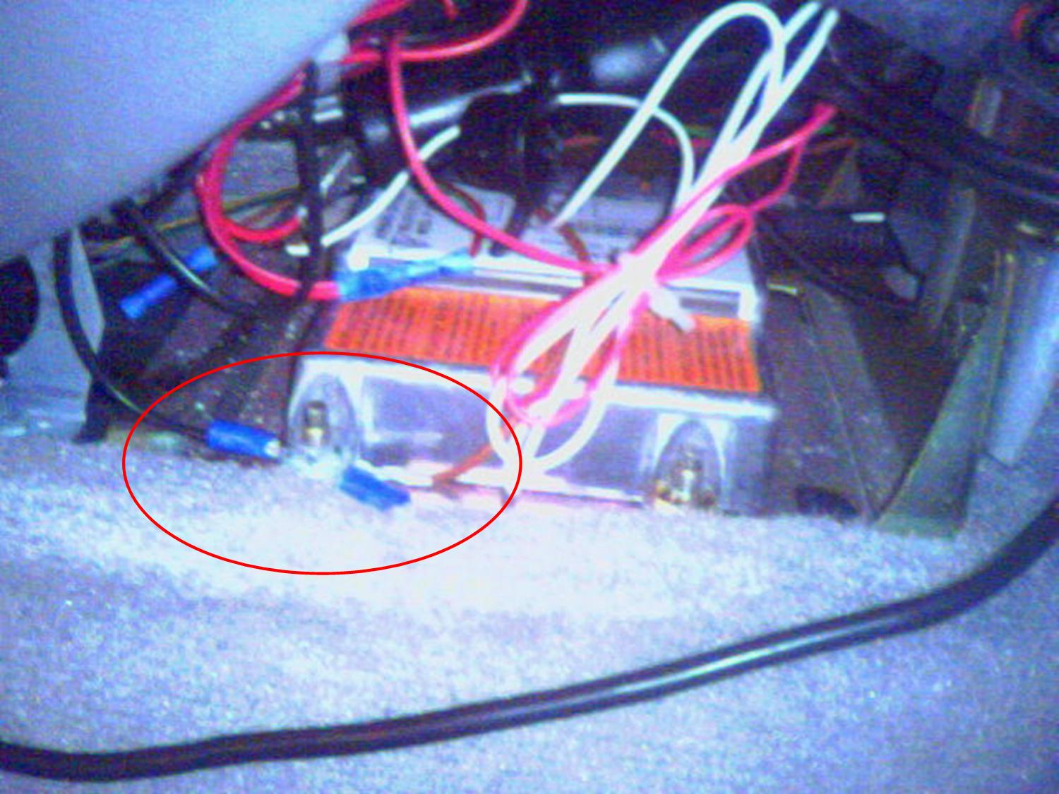

DIY – Sirius Starmate 3 and iPod Nano Installation Sorry for the poor image quality. My camcorder decided to drink some mouthwash on my last trip rendering it inop. I had to use my cell phone to take the pictures. Knowing that, I wanted to pass along a DIY job to show how I integrated my iPod and Sirius radio together with my Becker CDR-220. I do not have a factory CD changer with my Porsche, so I was able to use the “Aux-in” on the back of the radio. I purchased a PIE BLAU/8-3NPUT multi-au

Did you use the the brown wire from the phone cable for the ground? or attach the cround from the a PIE BLAU/8-3NPUT adapter to something else?

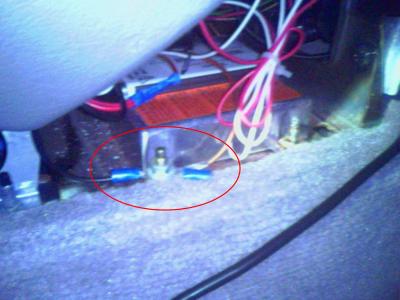

Mike,
I did not use/splice the ground from the phone connector. I connected the grounds directly to the grounding bolt seen in the picture. I included a couple of pictures to show which ground option I used.
