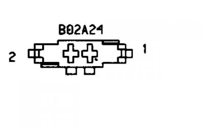

There is a cable not hooked to anything in the rear trunk of my '00 2.7L.
Anyone know what it goes to?
I looked up the connector in the Bentley and it is connector B02A24 - See Below

Yeah, I should have included that.
one is red and the other Blue with Black stripe
Will:
From the diagram that Loren posted at 8:32 p.m. on your "Rear Spoiler Comes Up at Speed" thread, it looks like the mystery connector is the one that goes to the "Tailgate Opener", as that one in the diagram shows the exact wire colors that you describe (i.e., a red wire, and a blue wire with a black stripe).

yeah, that's it. THANKS!! I didn't see the colors denoted on the schematic.
Thanks again!
