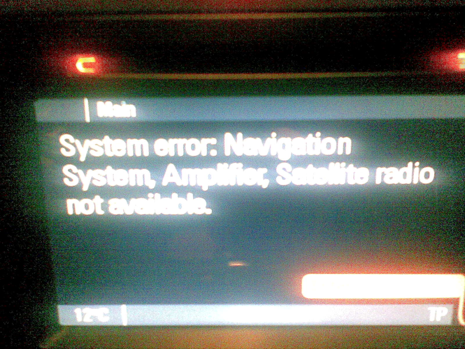

I replaced oem CD receiver by PCM head unit. Radio and CD changer is working properly, but PCM buttons do not work and after 3-5 sec error message appears on monitor ( no navigation, amplifier detected). Could you tell me how this message can be removed.

My guess is that you need to go to your dealer and have him program the PCM to let it know there is no Nav unit.

Yes I only installed a head unit PCM without nav module. Don't you know how to program PCM? My dealer a far from my place. Is there any other way of PCM activation than visiting the dealer.

Only if you can find a shop with a PIWIS tester.

You can only program your PCM (and any other MOST network components) with a PIWIS tester.

As far as I'm aware the only people to successfully retro fit a PCM in any car have been those with dealer support , when fitting a new unit sourced from Porsche. The PCM has built in theft security that links the unit with the car via the gateway module. If you fit a PCM from another car into your car , I would expect you need to re activate the PCM using the keypass procedure and the porsche workshop tool. The code for unlocking the PCM and re assigning it to a different vehicle , is obtained by your local agent on request from Porsche , having provided the unit and the vehicle ident numbers to them. The PCM communicates with the Navigation drive via MOST fibre optic, you will also need this to retro fit the pcm , as the car will not have it installed as part of the standard loom.

No, a PST2 will not work on a 2008 Cayenne - only a PIWIS tester.

One more time - You need to find a shop or Porsche dealer(OPC) with a PIWIS and ask them to program it for you.

The PCM retrofit installation instructions are in a TSB - and they are available here to Contributing Members.

I looked through the TSB on PCM installation. I found there a lot of useful information. According to TSB I connected A8 and C14 sockets on PCM connector. Now all buttons are working.
