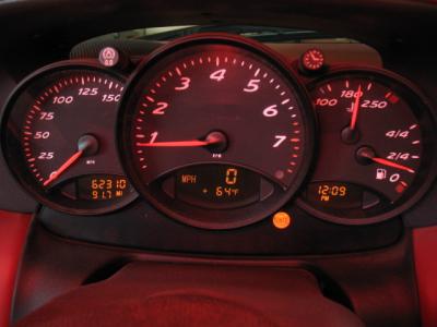

Where do i find the censor for the egnitions & is it accessable for a non mechanic? The light will come on aprox. every 70-100 miles & stay on for about 30-60 miles..?

The check engine light indicates any of hundreds of possible problems. So there is no one single sensor for it. You have to read the code through the OBD port using an OBD reader. The OBD port is just to the left of the driver's left knee just under the dash. Most auto parts stores will read the code for you for free. Once you get the code, post it here to get advice on how to proceed.
I would like to find the censor for the check engine light, as I am tired of seeing it....
