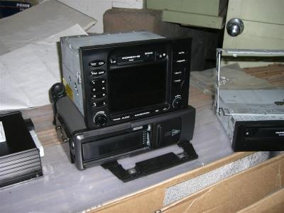

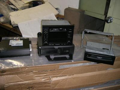

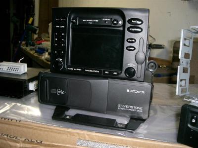

Its very much a PCM 1 .its non most and will install in any car pre 03.
It looks like PCM 2 so it will only work in MOST equipped cars (MY03 and newer Carrera's).
2000 C4
It very clearly says PCM on the side.
Part Numbers:
99664210502EFR
99664212200EFR
99664531100
And the Becker 6 Disc Changer
Perhaps it would be best if you listed the part numbers of what you have...
99664210502EFR PCM Control Unit (replaced by 996.642.905.04.EFR)
99664212200EFR Computer (replaced by 996.642.122.03.EFR)
These are PCM 1 parts and the two parts must work together (by serial number) and will only work in a MY01 or older 986 Boxster or 996 Carrera.
The last number is an older amplifier (M680 with digital processing).
Unless someone has a broken PCM 1 or want s spares the NAV parts are very outdated.
Also, the PCM 1 is pretty hard to retrofit since the wiring is not here on cars that did not have it.
You can post it for sale in the For Sale - Parts forum if you like and see if there is interest.
The amp and 6 disk CD changer are more popular options.
But I doubt either will much more than $100 each... again you are welcome to post them in the For Sale - Parts forum.
