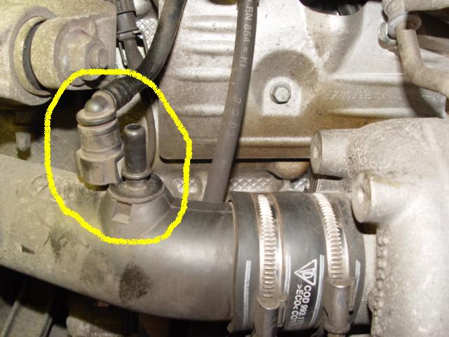

Well I guess all is well, finsihed the job today and all the old plugs look good. Slight amount of oil in the bottom of turbo intake hose, got that out with a rag. To confirm the blowby theory I disconnected the small hose from the intake hose and probed inside the hose with a white wire and was able to confirm this as the source of the oil. So, engine is sound, turbo is sound and I had a litttle blowby oil in the intake hose after 30K miles. The upper (turbo output) hoses in the engine compartment are clean and dry.
