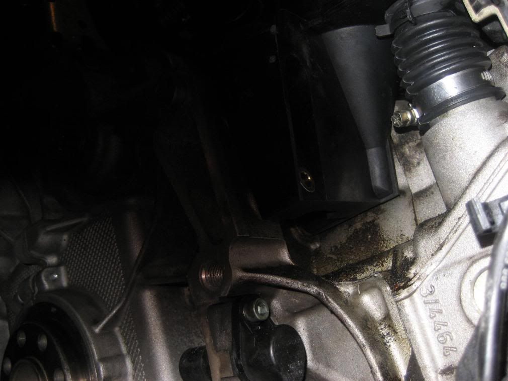

My old AOS out:

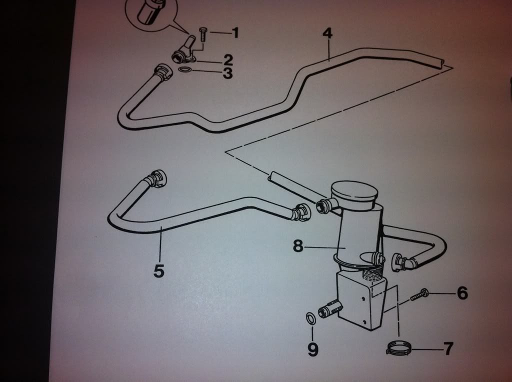

I've been searching on replacing my AOS and I'm a bit confused on what parts are mandatory in replacing. :unsure: I've check out the Pelican parts website and it seems all parts are sold separately. Can anyone chime in and steer me in the right direction?? :help: I have a 02 S. Any help is appreciated!

You will need the Air Oil Separator (AOS) or sometimes referred as Crankcase ventalation. It is #8 in the photo below. The AOS comes with the bellows tube and is not visible in the drawing. You also will need the "J" tube which connects the AOS to the throttle body or TB. It is #5 below.
Here is a shot of the bellows tube that comes with the AOS. The bellows is the short accordian like tube and attaches the AOS to an opening in the crank case.
