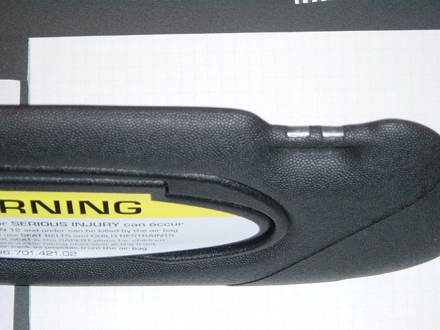

The visor has no wires that go to it - all electrical contact is made through the metal clips when it is seated (see pic). You will need the clips with the connectors built in and then run +12 volts and ground to a switched connection (986.731.541.01 mounting plate - 2 each; and 999.919.120.09 oval head screw - 2 each). And the visors - 986.731.031.13.EBY Left visor (with light) in black and 986.731.032.13.EBY Right visor (with light) in black.

Thanks for replies. I actually bought a pair of used visors (the complete assembly) and they look like they already have the electrical contacts where they get screwed in to the windshield frame.
Since I haven't yet taken the old ones off, I was actually wondering if the windshield frame part where they get screwed in already has electrical contacts built into it.
Otherwise, like Loren says, I will have to run a wire to a switched connection down each A pillar.
