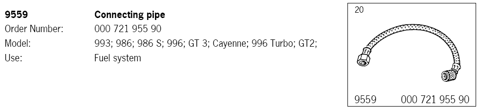

"Connect pressure gauge (special tool P 378a) with connecting line (special tool 9559) and connect to test connection."

Ok, so I bought an Actron CP7818 fuel pressure tester, which has an attachment for Schrader valve fuel test ports. It turns out that the threads on the Porsche are finer than a standard Schrader valve. The attachment that came with the kit screws onto the tire valve fine but the fuel test port seems to be more like 1.25 thread size.
So now I need to find an adapter from standard Schrader to 1.25 (or so). If anyone knows of one, please tell me.
The plot thickens...it's even worse:
(From http://iecoklahoma.com/adapters.aspx)
"A few of the high-end imports (Porsche, Lamborghini etc) have a proprietary port, often an M14 x 1.5"
I think that I could probably just get the Porsche special part 9559. I think that's just the adapter. Does anyone know where I can get it?
Edited by Loren
Fixed link
Yikes. That part is expensive. It is about $150 and I can't be sure that it will fit my existing tester since I don't have specs for it.

Everything they sell is expensive, I recently priced a PIWIS system and it cost more (just for the first year) than I paid to add a full bay and lift to my shop...................anything to keep the independents’ out of the loop.............
