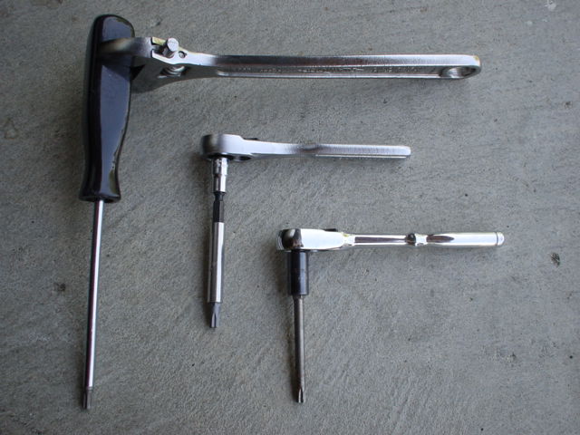

Mine were super tight too. Keep at it. I used a "L" torx and clamped on a vice grip for additional leverage.
There is blue loctite on the threads. So it does take effort to break them free.
Removed a few air bags over the years. Finally bought the long T30 bit for my ratchet wrench that is on the far right.
Also, you unscrew the screws in the normal counter-clockwise direction like removing a lid from a jar. So keep this orientation in mind as you will be working "backwards."
If you are using the long screwdriver type then rotate the wheel so that the hole faces your legs so that there is clearance to rotate the tool. When all I had was the screwdriver type I would have to put a crescent wrench on the square handle to get enough torque, like in the left of the pic. If you have a round handle screwdriver type, I hope you have a strong hand grip or you will have to use channellocks or vice grips on the handle to break the screws free of the loctite.
Also, the screws are on a slight angle. When you stick your tool into the hole in the back of the wheel your tool needs to be at an angle.
