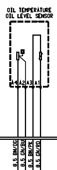

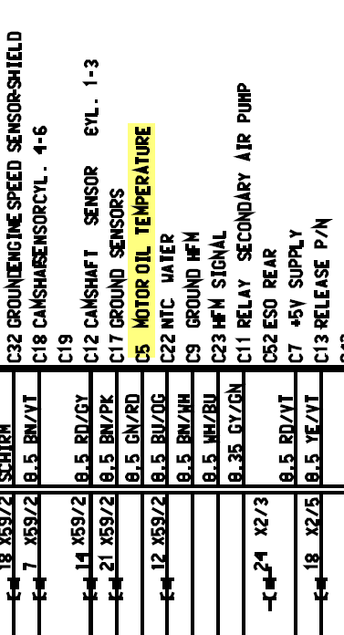

Oil Temperature is a function of the Oil Temperature/Oil Level Sensor.
It is read by the DME (all models that I am aware of). So, theoretically adding an oil temperature gauge should be pretty straight forward.
MY03 shown below
