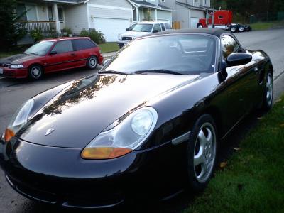

Neither of those lights are technically legal because the do not have DOT on them, with or without the tint. They are euro amber lights that were tinted in Germany.
Henry had a bunch of lights and we tried them on Aileen's black Boxster a few years ago. To make the bulbs brighter Henry came up with the idea of replacing the single filament bulbs with dual filament bulbs.
Another test picture.
