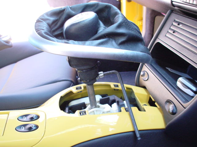

Hey All,
Really hope its not as obvious as i think it will be! Just got my B&M kit in the post and preped myself ready for fitting it. I bought the 9x6 werks DVD's to help me along so i thought i was all ready to go. I go to remove the shift but i don't have a set screw? In the instructions it mentions that some shifts don't have on and to use clamps on the lever collar, but all is perfectly round rubber collar which when i try and twist off doesn't budge.
Anyway got any idea's, i think i have the Tequipment leather shift knob. I am sure its gonna be pretty obvious but i don't want to mess it up!
Only the aluminum/leather and CF/leather knobs have a set screw.
If there is no set screw then you have a twist off knob. Best to put the top down and pull harder. Be careful to not hit yourself it the face too.
Just pull directly up or twist as well? - really appreciate your help Loren
The standard shift knob does not have a set screw, only the optional knobs. It is easy to see the set screw if there is one.
The standard knob is just a friction fit. You pull like heck to get it off, and if it does not pull off then you pull harder.

Thanks everyone for all the help - i think mine must have been Gorilla Glued on! Finally got it off by putting it into reverse then sitting in the passenger seat, bracing my feet against the floor and pulling like hell (didn't hit myself in the face either!!)
The B&M makes a hell of a difference - very pleased. On with the next mod.....
