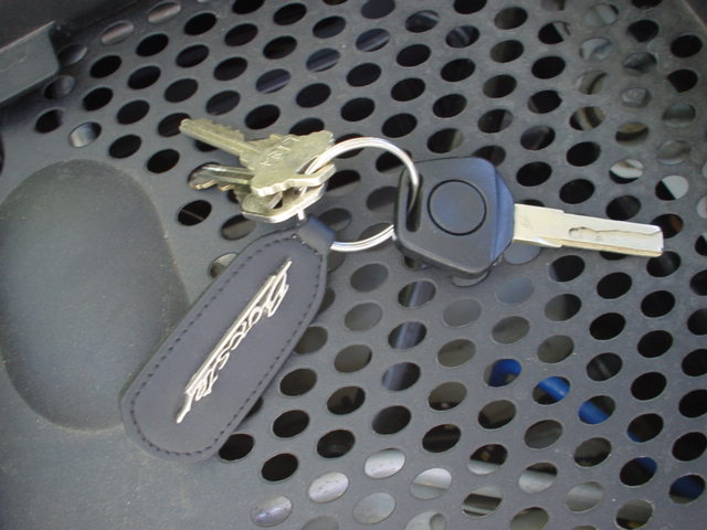

If you dont have a door lock button on your FOB then that means your likely have been using the valet key. I think all boxsters come with the factory alarm, You'd have to order a Fob for your specific year boxster and have the dealer program it. Only down fall that i dont like about the factory alarm is that it doesnt honk when you lock or unlock it, only blinkers flash. The only time it'll honk is if your factory alarm is malfuntioning or you left a Door, hood or center arm rest console opened.
When I bought the car, it came with 2 laser cut keys with just plain fob's that has the Porsche emblem on one side and a push button on the other for a embedded light. I also received a third key. The third key had a molded grey-in-color fob that I was told is the valet key.

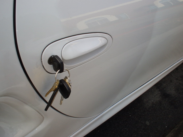

The 2.7 did not come with the remote/alarm as standard. It was an option on the base Boxster. If you have a passenger side door lock like this then you do not have it.
Also, if you had it your would have the option code 535 on the option sticker.
TP,
You are dead on. I DO have the passenger side lock. I also verified the option codes and do not have 535 listed. Now I know. I guess I'm sticking with a third-party alarm system.
