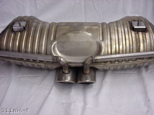

Toolpants, a month or so ago you mentioned you had not yet seen any pics of the 2003/2004 Boxster Sport Exhaust, well I had my car up on a lift today after helping a friend install his PSE on his 996 and so I figured why not take some pics for you. So here they are:

Very good. Your pictures show why the original sport exhaust will not fit on a pre MY03 due to the change of the rear bumper cover despite what others say. The by-pass pipes are now on the side of the muffler so they do not hit the bumper cover lower extensions.
I have posted your pictures on the German and UK Boxster boards with credit to you as they have been asking questions about why they cannot get the sport exhaust for the facelift Boxster. Back in January CAR on the German board called Zuffenhausen to find out why the Germans could not order the new style sport exhaust. Zuffenhausen said they were waiting for TUV approval but it had nothing to do with a noise issue.
I can tell from your pictures that the same bolt on tip style that started in MY03 is being used, so there are 3 tips that will fit.
I hope to hear the new style sport exhaust some day. The original style never had the "bark" that a 996 sport exhaust has.

The new Boxster Sport Exhaust definitly does not sound anything like the 996 PSE. I got the car on the lift after installing a friends 996 PSE system and so I heard them side by side. The 996 is still the king of sounds, deep growl with a nice gurgle. The new Boxster PSE is much more agressive but not as deep and does not have the gurgle. I will attempt to take a couple sound clips of it on and off so you can get little bit of an idea what I am talking about. I don't have a good recorder so I don't know if they will work but I will try.

The original sport exhaust was made by Eisenmann in Stuttgart.  Do you see their name on your exhaust?
http://www.eisenmann-technik.de/export/main/intro.htm
Toolpants, I am attaching a photo that shows a closeup of the part numbers. I tried to get a better pic today but since I don't have it up on a lift it didn't work. I took one of my previous photos and just cropped the part number portion. I played with the contrast to get a better view of the writing. While you can see a blurry "Eisenmann" I was able to see myself that it is in fact stamped on the exhaust. I hope this pic helps.

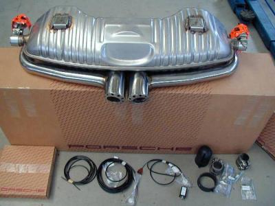

Does anyone know if you can buy the valve that is fitted to the exhaust. I want to see if these can be added as a after market to my exhaust, just welding a pipe in place with the valve?

I have a stock 03 exhaust I took off recently and would be willing to try this, if someone who knows the inside of the stock muffler well enough can give me an idea where to drill the holes for the bypass pipes' outlet ends. I'm sure they are rerouting a portion of the raw exhaust from the inlet area to a forward chamber and out.
A4EP...can you tell me where those bypass pipes are outletting? It looks like maybe above the seam in the back side of the muffler, maybe 6 or 8 inches in from the side ?

I have an old stock exhaust that has damaged outlets, I could rip this apart and see where the piping ducts to inside (it must duct to a channel)

I doubt if it can be ordered. I just finished the installation of the 03+ PSE and the pipe looks to be bent at the muffler factory, then welded onto the valves. The metal on the valves appears to be cast as well.
Simply adding the bypass pipes would be all you need to get good sound.
