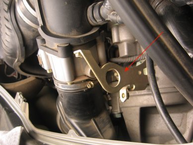

just looking around, and would like to know what this is and what is it's purpose?
Thanks.

Looks like the engine lifting bracket.

Thank you. step one, complete. LOL
Nick, are you saying that bracket would support the weight of the engine for lifting? Does not look strong enough IMHO.
That's what I was thinking prior to my post, as there are only two bolts holding it in place. But since I have never done anything like this, I wouldn't be the wiser. It also has two threaded holes to allow a nut/bolt- not sure what for, - maybe for securing a lift if indeed that's what it is for?

I always wondered why there were 2 welded nuts on that backet. Not used on a 986.
I have the answer to one. Used as a clamping point on a 996 for a hose(s).
That bracket is indeed for lifting the engine. As for the nuts welded on the bracket, the one that is up and down is for the vent tube for the tiptronic transmission and the one that lays down on its side is for the resonance box on some boxster intakes.
The other welded nut is for the sport exhaust commanding valve fixation for ROW.

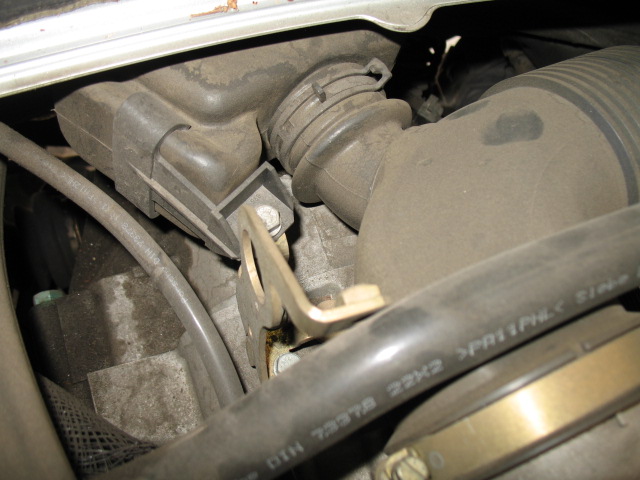

Should have first looked at the pictures of my own 2.5 before responding. The intake "muffler" is bolted to the lower nut.
I wonder how much louder or cooler the intake noise would sound with that muffler removed and the hole plugged with my desnorkeled boxster... Ill try to find a plug solution and let you all know someday.
I have a 3.4 engine in my MY98 >Boxter. When installing the engine, I reused the original Boxter intake hose, cutting it and adding short extension. At the same time I took the "muffler" away. In my opinion the sound is much better.
We were comparing a stock Boxter S sound and my (stock) exhaust sound, and mine was much deeper, much better! I have desnorkeled the intake as well...
Kare, Spain

I have a 98 5 speed and the bracket is also used to support the engine from up above when the transaxle is dropped to replace the clutch and flywheel and also to replace the RMS and IMS. It also provides a support for the little ear that protrudes from the intake tube that connects the air filter and the throttle body. This is the same intake tube that connects to the MAS. I recently had to reinstall the intake tube and found it real easy once I removed the bracket totally and then reinstalled it once the tube was in place.
