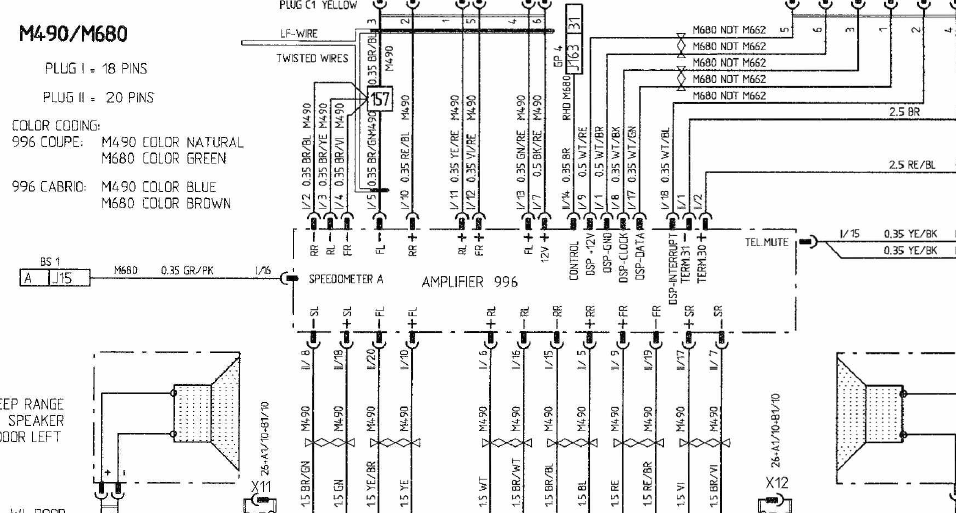

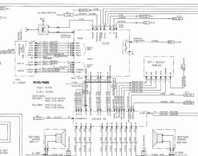

Thanks for the pictures to the wiring diagram -- I guess what I really need is the daigram to the pin placement on the actual amplifier. I'm not sure if the smaller (black plug) is different (it fits perfectly), but I am in need of the larger white/clear plug pin placement. The wiring diagram shows the specific speaker that each set of wires links up to, but the schematic of the amplifier is necessary in this case. Thanks in advance for your help!

What is the exact model and year of the car the amp came from?
Thank you, Loren, for this diagram, but I'm afraid that's still just the inputs and outputs of the amplifier in relation to the vehicle.  What I was looking for was a schematic for the internals of the amplifier itself, which is likely proprietary and available only from Nokia or Harmon.  However, I doubt they're going to give them up, which is why I tried you first.
Porsche replaces sub-assemblies so I doubt they ever had them either. If an amp (or immobilizer, or other control unit, etc., etc.) fails - Porsche just replaces the whole box.
You could try a few salvage yards or just replace it with a 3rd party newer style amp.
